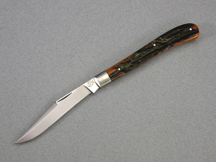

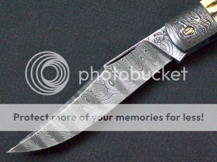

I used a flex shaft hand piece (similar to a dremel) & the thin cut off wheels for years and got pretty good at it free hand. Here are a couple of those.

I am using the flex shaft dremel free hand on the finished blade in 2 steps.
1) cutting the nail nick with a dressed grinding stone
2) cleaning/polishing the cut with a dressed hard cratex wheel, "sharpening" the cut ends to a point, adding more belly to the smile and deburring/softening the straight upper edge.
The cratex wheel cut less, but keeps the dressed edge better while the grinding wheel (those dremel implements) is faster but leads to rounded nick ends very quickly.
