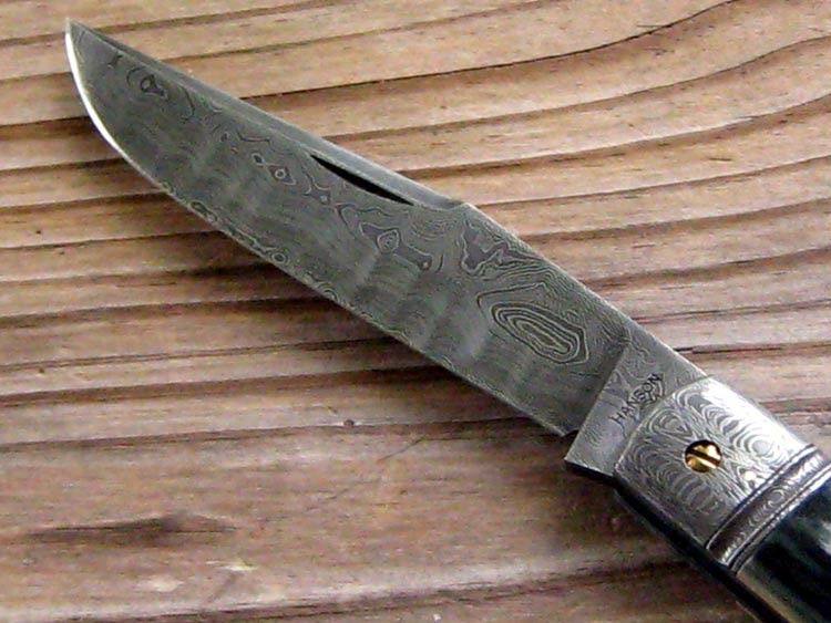

Cutting Nail Nick on Folder
Beautiful nicks!!
Don, do you use a jeweler saw free hands for the threads?

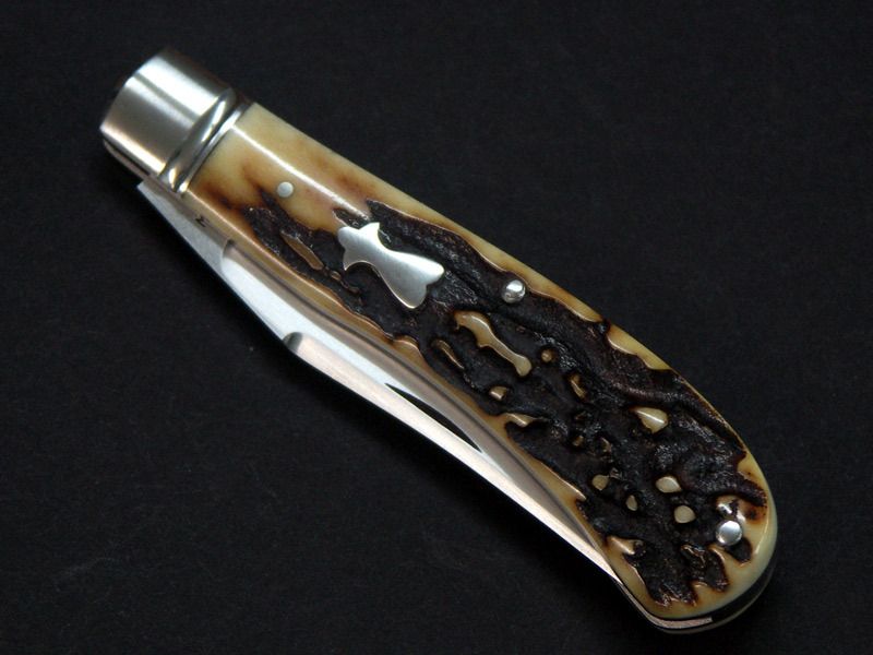

Don, up today i've always made pins flush with the scales, but i'd love having the pins like you did in that stag knife.
Do you have some tip to share how to dress the domes so clean without ruin the stag and without the awful burrs we usually see with spun pins?
Stezann, I spin the pins in a drill press and lightly finish them off with a scotch bright wheel, then buff. I use the corner of the scotch bright wheel and try to hit the pin from all angles.. The head spinner is one I bought from one of the knife making supply places, but have reshaped it to where it makes less contact with the handle material. It's not a very precise way of doing it, but it's quick and I like the results.
