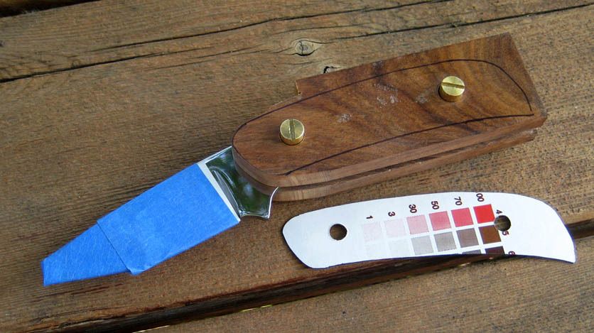

Though I have very little experience with this, from what I've seen and read, it's very helpful if you can finish the front of the handle scales before attaching them to the tang. Then you won't have to try to shape, sand, and finish them without scratching the steel adjacent to the handle scales.

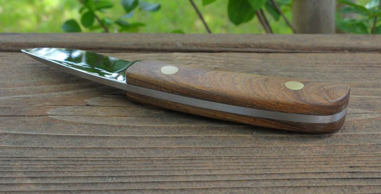

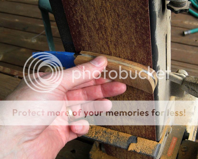

I'm mostly a beginner at this, here is one that I did a few years ago. I do use a small drill press for the holes. :

Nice work micarta, I am way more a beginner than you, its literally my first knife here. I spent 8 full hours the last 2 days sanding down two scales with a piece of glass and 40 grit paper lol. That belt sander would be awesome, not gonna happen here though. Jason, I am planning to move to Portland next year with my gf so I am just gonna do the work here in the apt. till then. Yes, your right the dust gets everywhere doing this work. I literally had to go buy a new vacuum today with a wand hose to get it all up lol. I got the first two scales soaking in linseed oil now, the first knife I'll be fitting these to is an 8" Chicago Cutlery 66S slixer knife... I have got way more labor in it than its worth, however I'm just using them to learn hence the free pine handles and only hand tools.

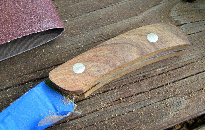

Have you thought about attaching the scales at full (1/2") thickness, then thinning them down during the handle shaping process? It would be less wood that you'd be filing/sanding off.

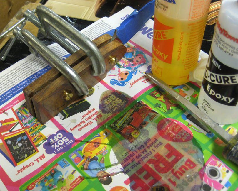

Thank you Ric, I attached the scales today earlier. My brass tubes fit perfectly for pins, I JB welded everything and have it clamped up drying. I soaked those scales for 2 days in the linseed oil. I wish I could post some pics, but I can't figure out how yet lol, I have more patience with the knives than tech stuff. I bought a regular hand saw with fine teeth today, next time I cut scales I'm gonna rip the board down the middle and it will save hours of sanding... I put dimples inside the scales with my drill before I epoxied it up, I saw pics of people doing that to create spaces for the epoxy. So far , so good. One problem I created, I dented the scales with my clamps a 16" or so in 2 places with the c clamps, so when everything dries up I'm gonna just sand them down flat again with the pins now in place. I have a pretty coarse stone I can use too if I have trouble sanding with the pins in, they are brass tubes so not really that tough to sand I'm sure. I got some j.b. weld inside the tubes which sucks, but I'm planning to use my small round file to file it out its just a small amount. The main thing I learned today is to be careful with the clamps, I bought myself a lot more sanding now to get those dents out... The only thing I can't see being able to cut down the time on for the rest of my knives is mirror polishing the blades, it took a good 6-8 hours of just 60 grit sanding for this one blade. This is one thing I might invest in the dremel for. So far so good though, it was really cool to see my handle going together today!
Next time I assemble a knife with these tubes, I'm gonna put some paper or something in the tubes to keep them from getting the JB weld inside them when I put it together. Lol , I just got up and found some q tips and got most of it out wet.

I would also leave the scales 1/4" wider then you had planned, mount them and then sand to size. You will be surprised to know that as you are shaping a handle while on a knife, you might find yourself feeling that the knife "wants" a different handle shape, or it feels like it can be manipulated easier with one part left a bit wider or a different balance point.
