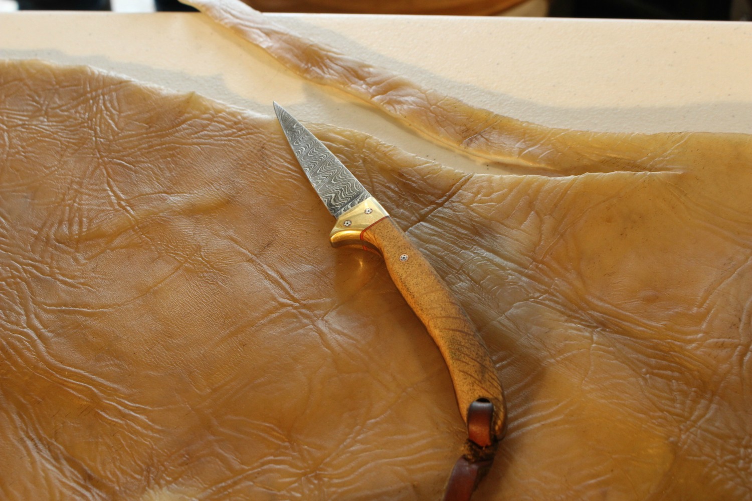

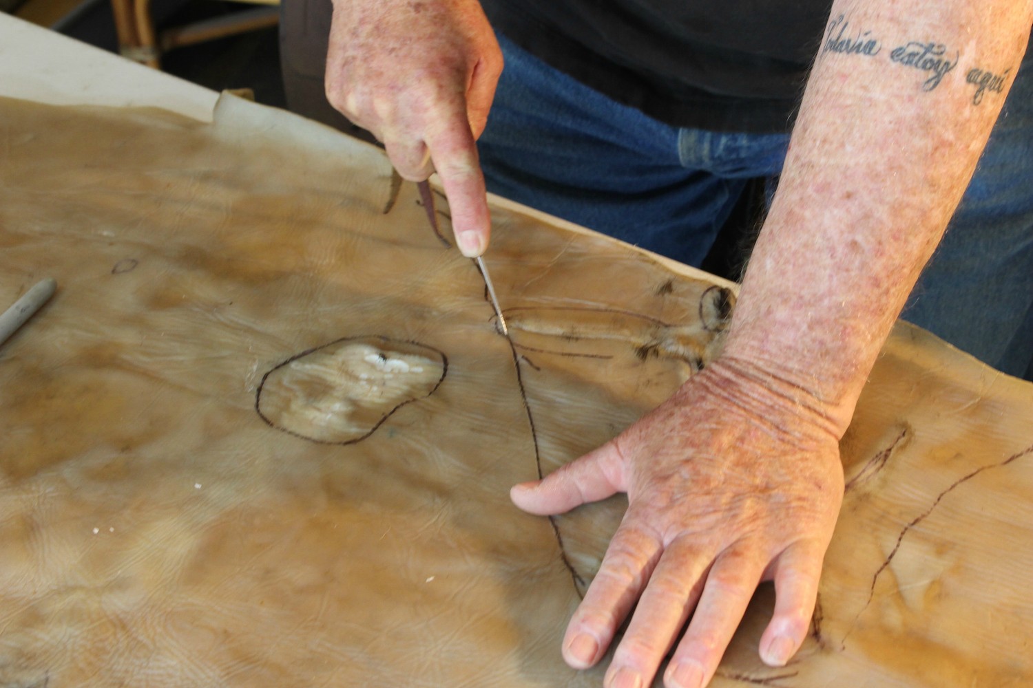

So anyhoo a buddy of mine has started on making one and I thought I'd post up a few pics of it here. There had been lots of discussion about cutting of leather and what I found interesting in this situation is the knife that Steve choose to cut his rawhide with. He'd experimented with some utility knives, kitchen knives and just about all kinds of sharp edges. I'd even loaned him some old Osborne roundknives that I'd ground down over the years into half round teardrop shapes. He'd tried some special string cutters for lacing and you name it he tried it. What did he end up using? His damascus EDC (Tapadero Model) that I'd made him some years ago Now as a knife maker I'd of told ya damascus was the wrong steel and the Tapadero was way the wrong shape. Its kind of long and pointy and was designed for the branding pen (great for castration and ear marking of cattle thats what its job was inteded for). But here ya go. Moral of the story is use what works for you and what you can do the best job with. here in these pics Steve is cutting the bad spots out of his side of rawhide. He'll then cut it into a large circle. From that circle he will cut four 1/4" strings each 90' long. There's more prep work that goes into the strings before the braiding but thats what he's doing with his knife.
So to braid a 60' reata Steve needs 90' strings.
Thought this might be of interst. I found it interesting that the knife that "shouldn't" work well for this task is what he prefers. Steve could also afford any specialized tool for this job he might want. This is what worked best for him. Questions and comments are welcome of course.
Dave, if you mentioned it, I missed it, but that rawhide he is cutting is most certainly cased and wet…..Right?
Paul
Yes sir and I did forget to mention it. Keeping the mositure content in the rawhide just right is one of the trickiest parts of the whole deal. Too wet its like trying to cut limp noodles. Too dry and its like trying to cut plywood with a knife. He's got all his strings cut now and he'll wait till the onset of fall to go further. Easier to work rawhide in fall and winter when there is some mositure in the air. He soaks the hides in a water trough and then hangs em between two trees. They say the right time is when the rawhide feels cool to your cheek.

I think I talked about this somewhere else here , but years ago I worked with a guy who made Green Hide Ropes ( the same as what you call Raw Hide it think ).
He didn't braid them , but twisted the strands in a set up that used pegs driven into the ground .
He always said the art of it all was in the cutting of the strands and the thickness of the leather determined the width of leather he cut , at times it looked like he must have been drinking because the cut strand would not be a consistent width .
He cut it with a small fixed blade knife , he push cut away from himself and he ran the leather through the fingers of his left hand out in front of the cut , he said to feel and judge the thickness of the leather so that the volume was the same and the finished rope was a consistent diameter for its full length without bulges .
