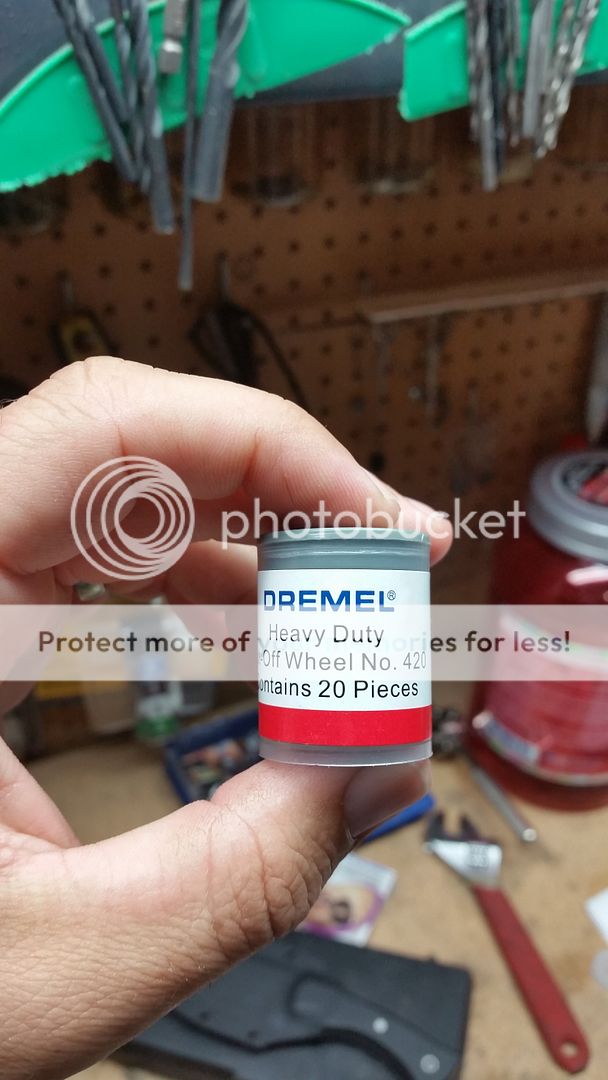

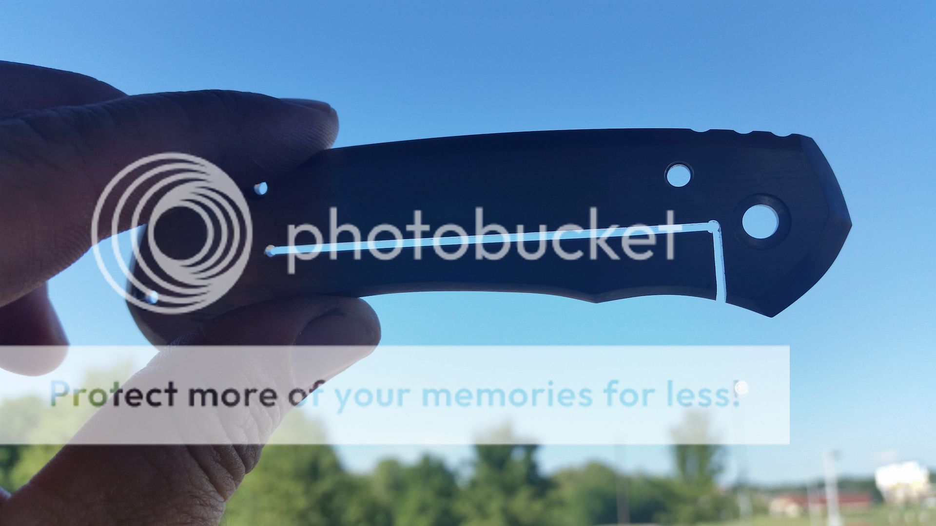

I have just recently completed my first lock bar cut and here is what I used.
They are jus Dremel non reinforced cutting wheels you get at home depot or Lowes.
Only bad thing is they are not very big but I only had to use 2 disc to make the cuts.
They left a nice cut..I think.
