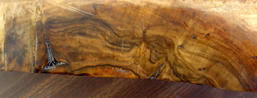

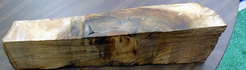

need to know what some options are for me cutting this wood up
there is a crack running up it near the middle should i cut it across the graini like it is now or try to cut along the grain in hopes of saving all i can
the tree was in a friends yard and his now dead grandfather had planted it so he wants a few knives made with it in memory of him
its walnut and had been dead for 3 years now and its mostly dry but i just had to see what it looked like before i dried it out all the way
thanks
butch
that crack may not go as deep as you think. Cut the scales 3/16" thick and you can get a couple more out in the end. Add black liners to it and it will beef up the wood back up if you'd like. I'd cut it on the saw in the position like it is in the top photo. How long is the wood up to the crack?

Looks like you have a good bit of wood there. What you might try to do is to cut your blocks without cutting all the way to scales. Then, send those blocks to WSSI for satbilization. After that cut them into scales. Stabilizing will help it from cracking further, and for smaller cracks you can fill in with superglue, etc just prior to finish.
What folks have told me is to stabilize the biggest hunks you can and cut AFTER to avoid warping of thin sections.
Also, add a bolster to the handle and the wood can also be smaller...........
so you think to cut it across the end grain
and the bolsters are some good thinking
thanks
I'd cut along with the grain so what you see is like what you're showing us in the top picture. You want to maximize the curly bits, so think of what you want a scale from the outside to look like in that wood, and cut accordingly :)
