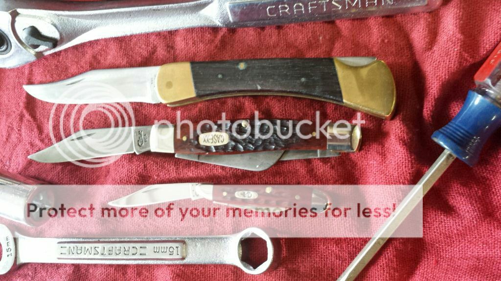

I've got favorites in each. This Case 6375 in CV and the Peanut in SS.

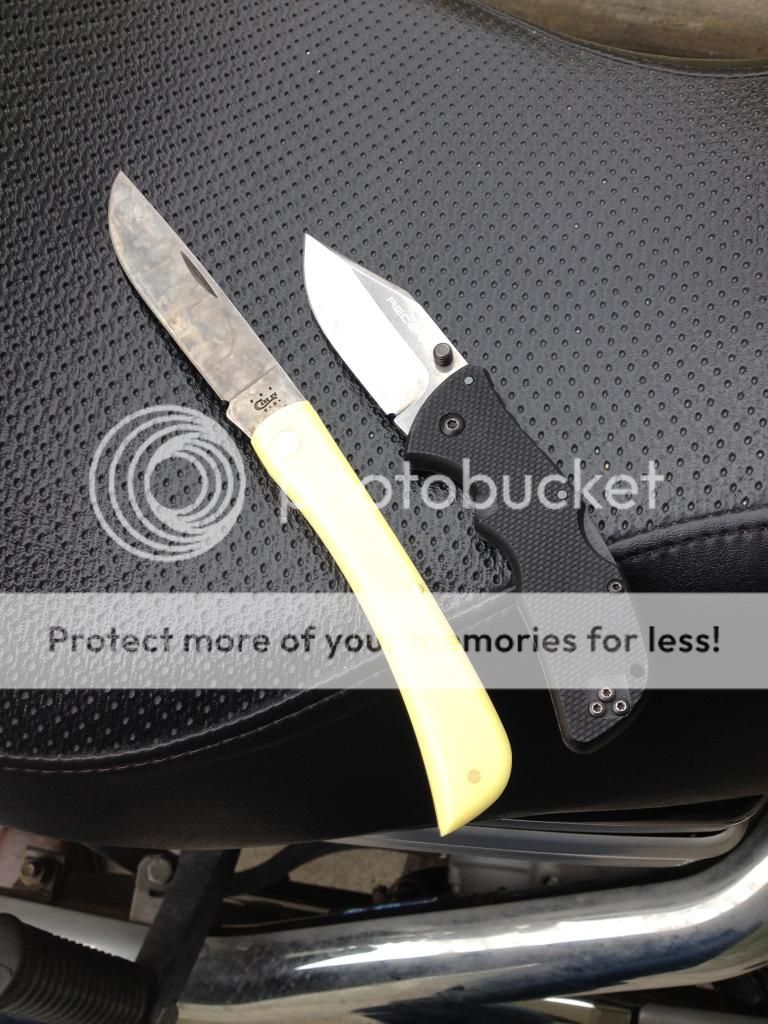

On Topic: Here is a Case Hawkbill Pruner in CV that I used all summer long for gardening tasks. Heavy use with lots of sharpening and sweaty pockets. I did take care of it by thoroughly cleaning and lubricating when brand new - and giving it at least a wipe off on the pants before putting it back in the pocket.
At the end of each day of use it got a quick soap and water bath, and then compressed air blasted to dry. Air dry in the cockeyed blade position for a couple hours (or overnight) and then a tiny drop of mineral oil onto each pivot side.
In comparison to Stainless Steel; you could probably do absolutely nothing to it except use it and sharpen it and it will be just fine. (I still recommend the initial clean and lube when new).

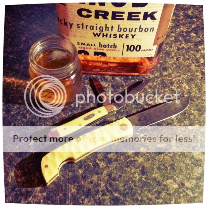

One sad thing about the stainless blades is they never get to look like this:
It also looks like one of those knives doesn't belong in this forum. Keep it Traditional folks.
