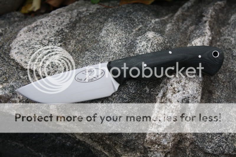

Here is one headed to my buddie in the land of fantastic Beer.
Nick:)
A beauty. I like the pin placement and jimping. Hell I guess I just really like the whole knife.
Good stuff.

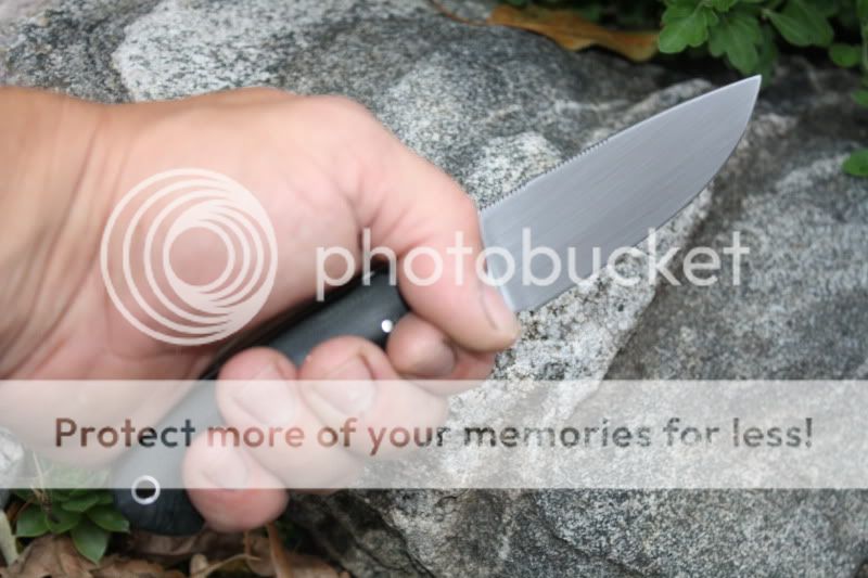

Is the rear of the handle on this one rounded a little more than normal? Did he request that?
Looks comfy as usual :thumbup:
This does have a slightly more rounded arse end. It also is full size and fits my hand well.
Nick:)
That's a great looking knife Nick. I like the way you've transitioned the first finger groove into the ricasso. Blade shape seems extremely functional as well.
