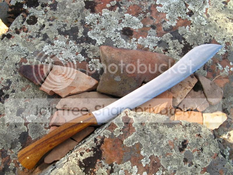

This one is 1/8" 1095, 18" OAL with 11 1/2" of edge. The handle is canarywood, cool stuff. This one is light and thin, only an inch wide at the handle.

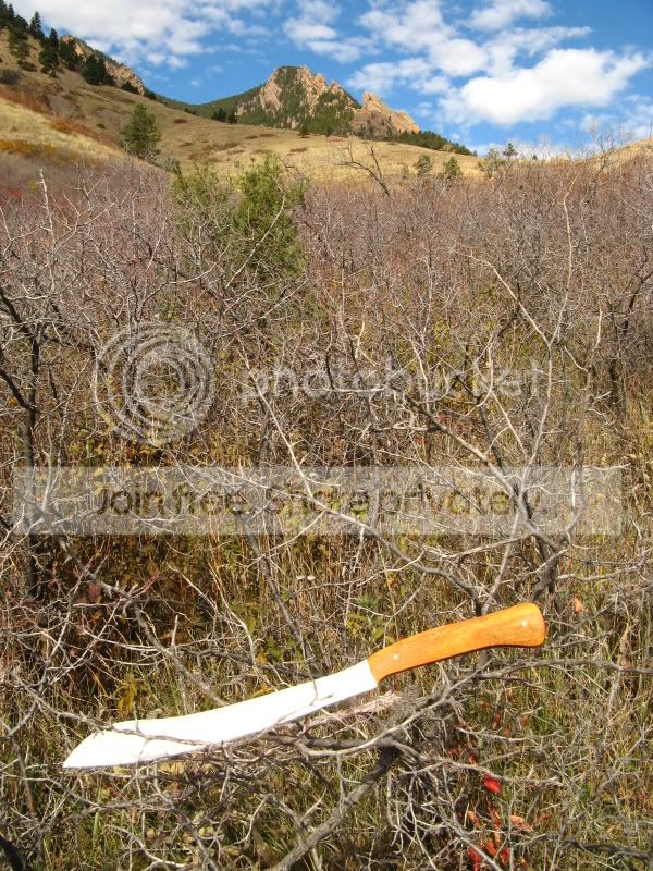

The trail I chose is always crowded with sumac and these nasty thorn things. The thorny suckers are a bitch to cut. They are springy and like to come lashing back at you. I have never had any knife that can cut these effortlessly.
Being light and fast the golok did well.

Tried to find some heavier stuff to chop. The little stuff was no challenge.

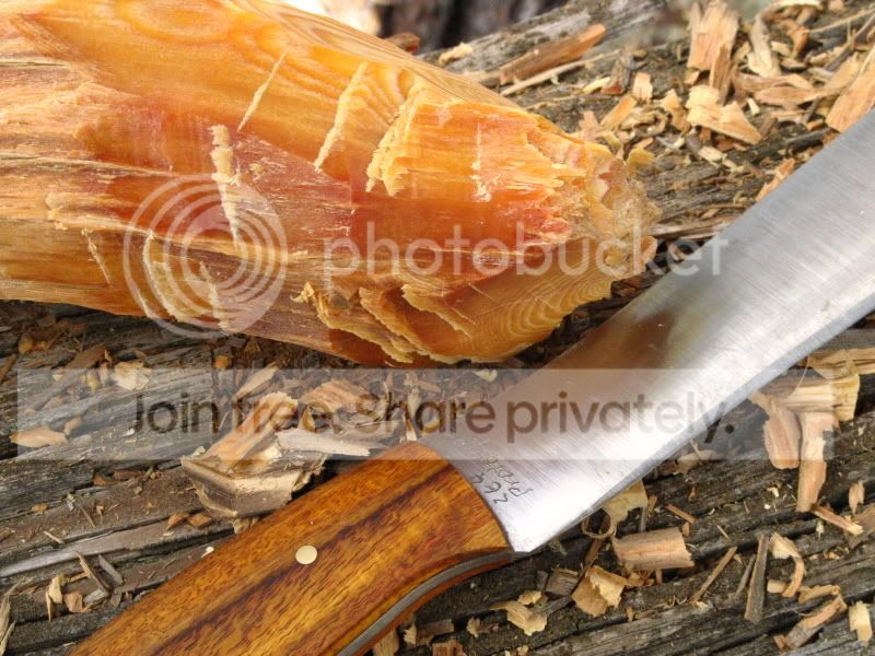

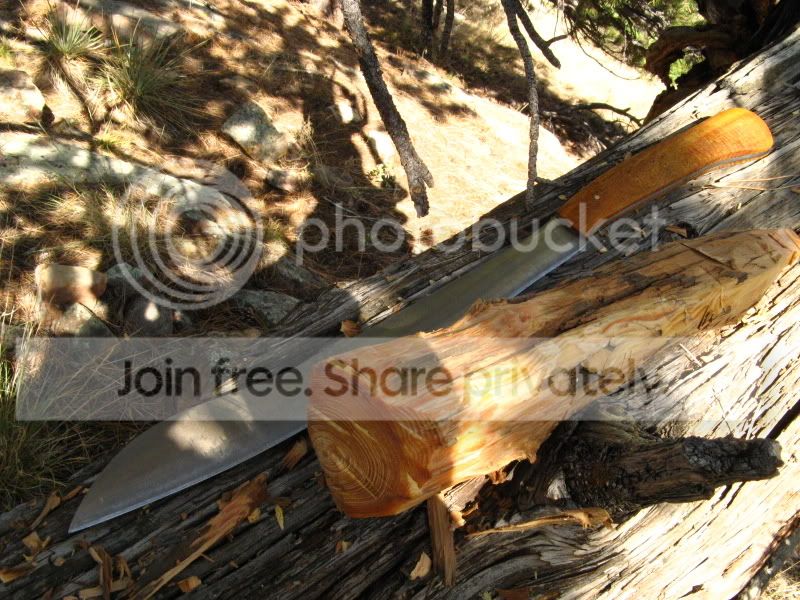

Found something worth chopping. Hard as hell old fatwood. Hit this cross grain and the golok would bounce off. I harvested three branches. It was more like precision extraction than chopping, this stuff is half way to being petrified.
It burns good.
Stopped to take picture of bird.

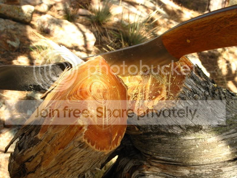

Chopping this stuff was the real test. I wanted to see what the golok could do. It does a number on soft wood and brush....but it can do harder tasks if it has to. After this the edge was beat to crap. No dents, dings or chips but the shaving sharpness was gone. Still cuts paper well but it will need a touch up.
