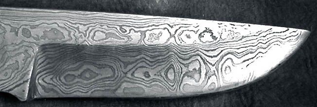

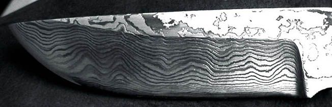

I was told that it was not forged. The shape was cut with water beam, followed by stock removal. I think the cause of the cracks lies in heat treatment. The knife was custom made and the maker says that heat treatment was done according to standard procedure to achieve hardness 60-61 HRC. He has no idea how could it happen. I decided to keep the knife and in compensation I obtained a nickel chrome steel (30NC11 - french name, with 19191 - sth close to 1095) damaskus blade and some Macassar for the handle. Here are some pics:

i was going to say overheat no foil too fast a quench
but thats just a guess on my part
butch
had to add i like the blade other then the cracks in it that sucks
