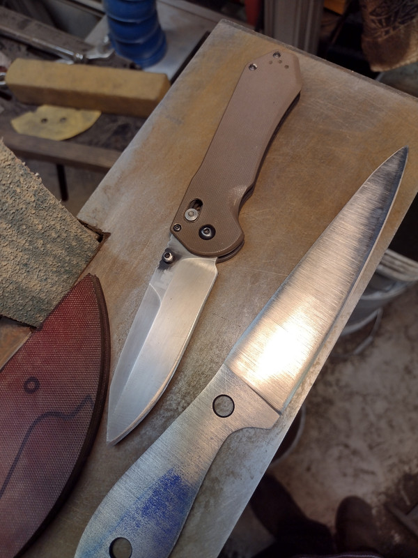

A few of my D2 knives:
I only have 1.5 knives that are made in D2 steel....
One is a HK Benchmade, and a Killing knife I'm currently working on.
I was reading about how D2 is currently being overlooked, yet still a favorite among Makers.
I wanted to test it more. I'm fortunate having this
