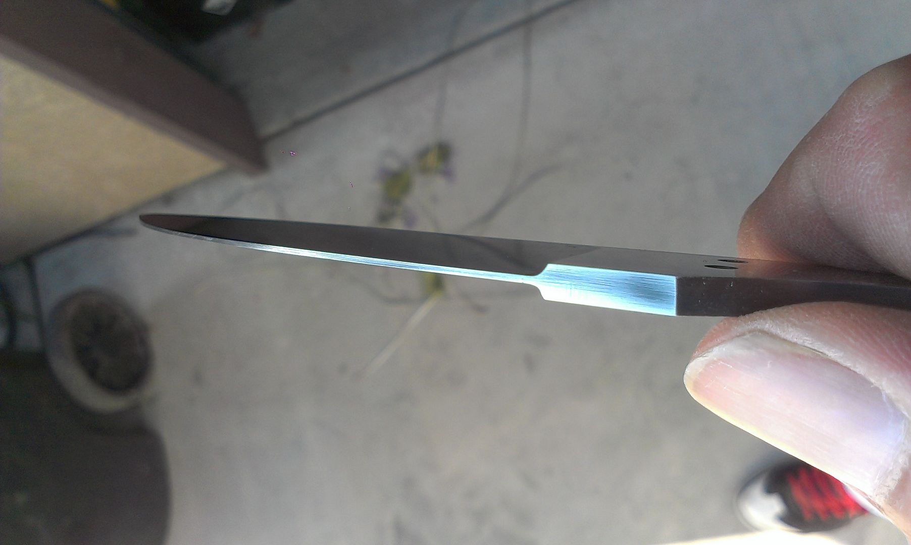

Just to be clear...
This is the "edge" I had to work with. :D
If I had sharpened it the bevel would have been obese. I mean obtuse. :)
Just to be clear...
I don't even want to think about how long that would take on stones! Definitely a job for the belt grinder;)
Not long with a 24 grit Nubatama ;)
Yeah, I thought about that as I ground it, and ground it, and ground it...
The final apex was done on the grinder. The re-ffg was all done by hand on various abrasives, diamonds, SiC, cut up belts etc... An ugly business that. ;)
