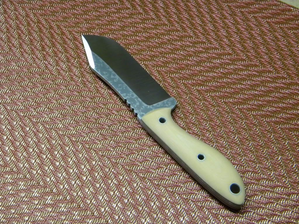

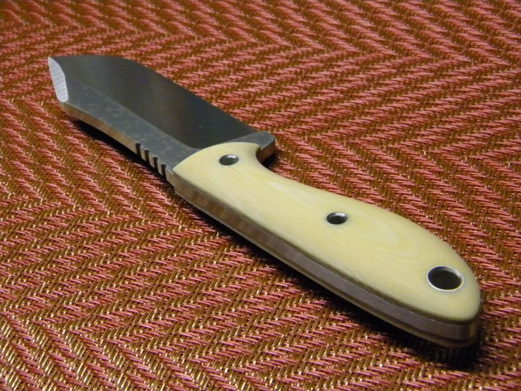

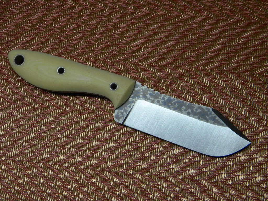

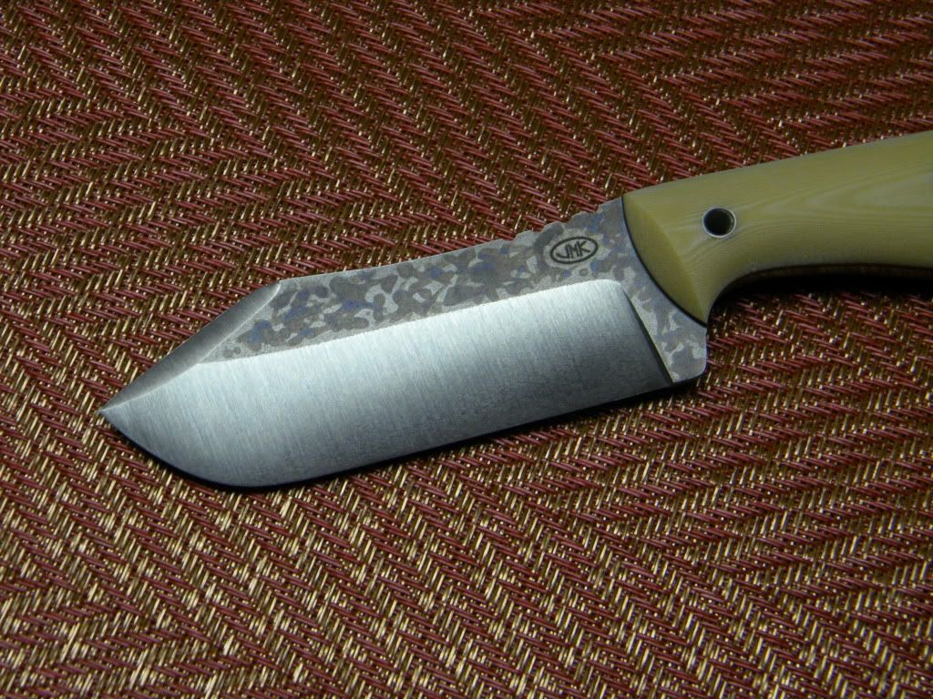

Just finished one up to add to my lineup for the OKCA show next month in Oregon. This is a standard Ness Mac in .180" thick D2, flat ground, hardened to RC 59-60 by Peters with a random etch on the flats. Instead of my usual handle style which can be a bit flashy sometimes I decided to go low key natural on this one, with bone linen G-10 slabs and brown micarta liners.
Thanks for looking, comments welcome
Your way to modest Bro. Nothing low key about it. That is a beauty, I love the etch on the flats.:thumbup::thumbup:

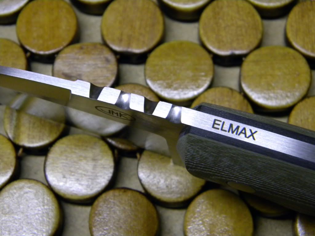

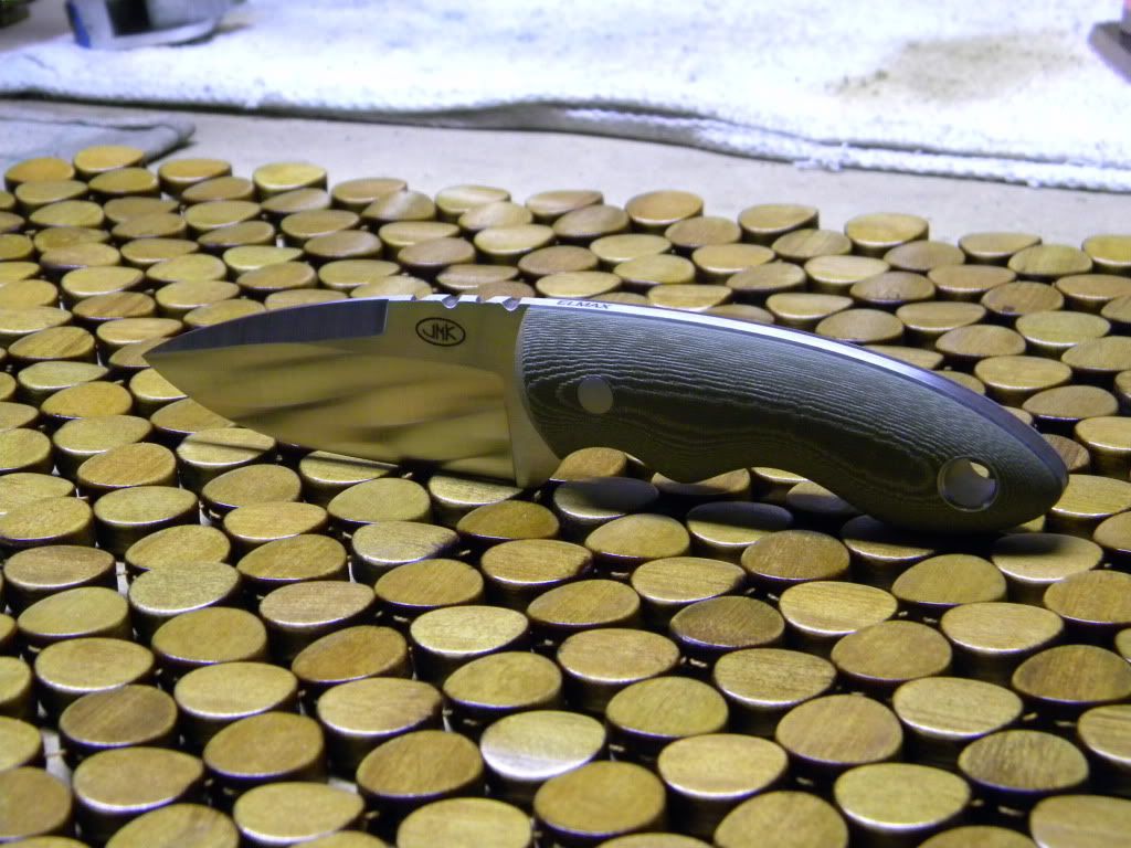

Adding some pics of a Mini Drop Point XL, also for the show.....
Elmax powdered stainless, camo OD green G-10 with black G-10 liners
That Ness Mac kicks some major arse! Would love to see it in Elmax, though. ;) :)
Their both really nice i especially like the mini xl myself and for some reason i really like your style. Its like your knives keep talking to me.:D
Very nice. I didn't notice the staggered jimping on the mini when I looked at it on FB, very cool.
I like the Ness Mac's finish and the variation from your usual without losing the essential YOU in the knife.

Remy, thanks for noticing the staggered jimping, thought I'd try something different.
