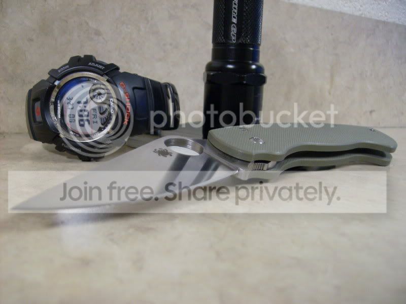

D2 sharpening angle: 30 deg or 40 deg? Can D2 hold up well enough at 30 deg, what with it's larger carbides, or is 40 deg the way to go?
CPM D2 is a little different than standard D2 and I think part of the diff is the carbide size, if I understand correctly what I read about it. Anyway, I have no trouble with any Spyderco at 15 degrees per side, including a D2 Para and a D2 Millie. That's actually pretty close to the factory angles.
I should add that 99% of my use is for cutting/slicing. I rarely do any kind of chopping or really heavy work with my folders.
Thanks, Dale. I also don't do a lot of heavy chopping/impact-type activities with my folders. That's why I have fixed blades lying all over the place! And I figured CPM D2 could handle 15 deg per side, so I already went ahead and did it. So far so good, just a few little irregularities along the edge that need a bit more work. D2 is tough stuff, but it wasn't as bad as I was expecting to take the edge back a ways.
Mine is holding it just fine like all my other Spydercos so far!
Hey Peter that blade looks a bit shinier than factory. Did you do anything special to it?
