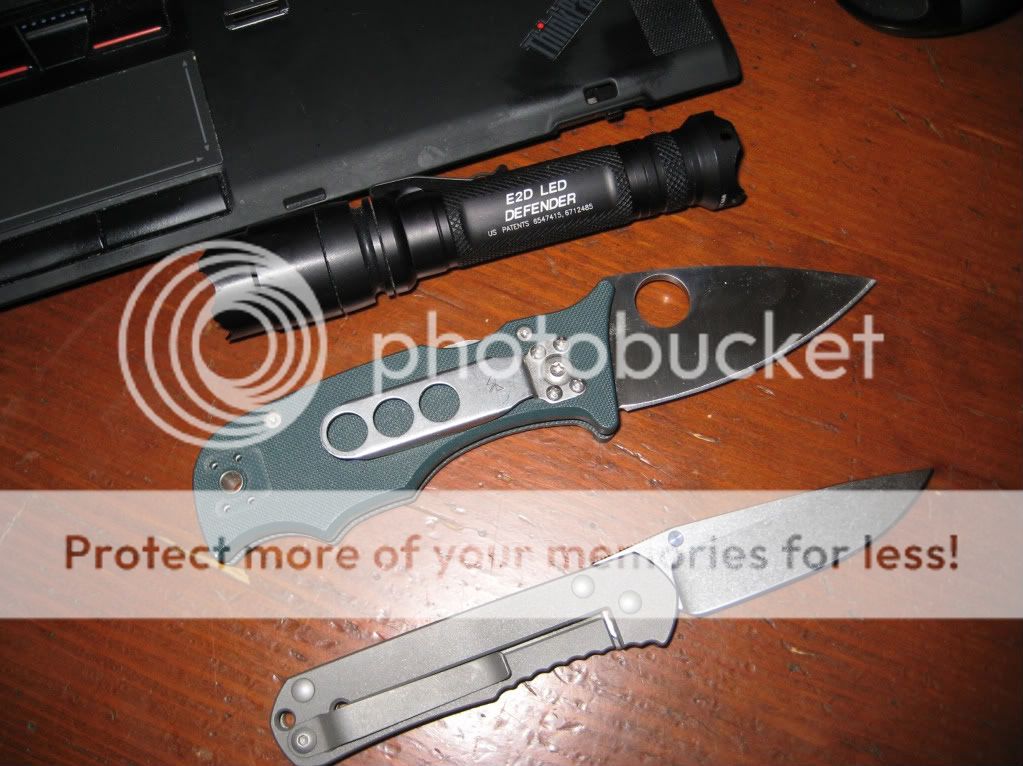

P. S. Below is a photo of my Li'l Temperance (S30V steel) in company with a small Sebenza (BG-42 steel) - both have ZERO BLADE PLAY.
