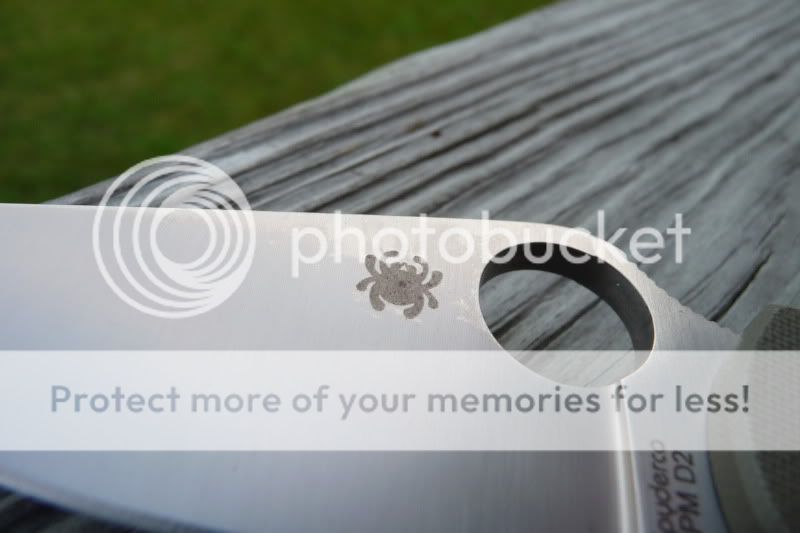

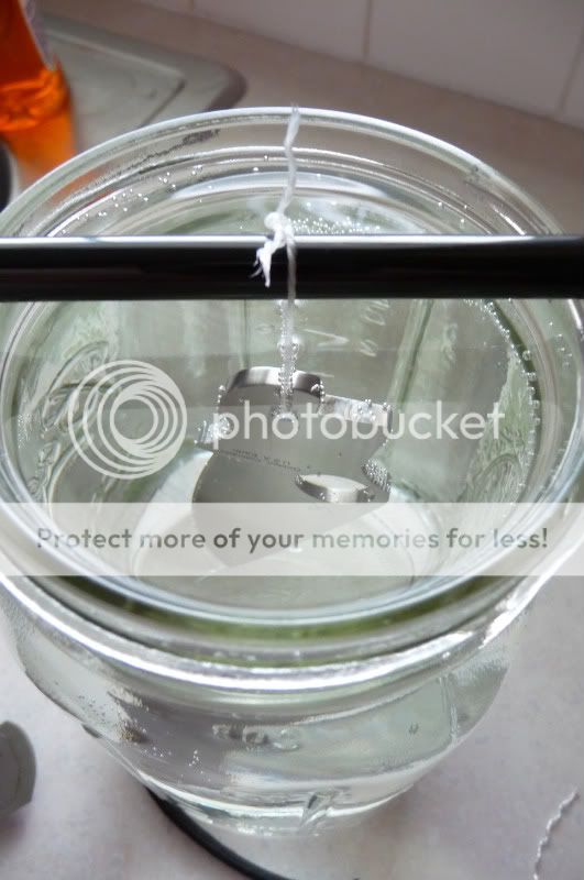

Here are pics of a satin d2 grip I patina'ed. The etching was practically invisible before the patina process.
attachment.php
attachment.php
