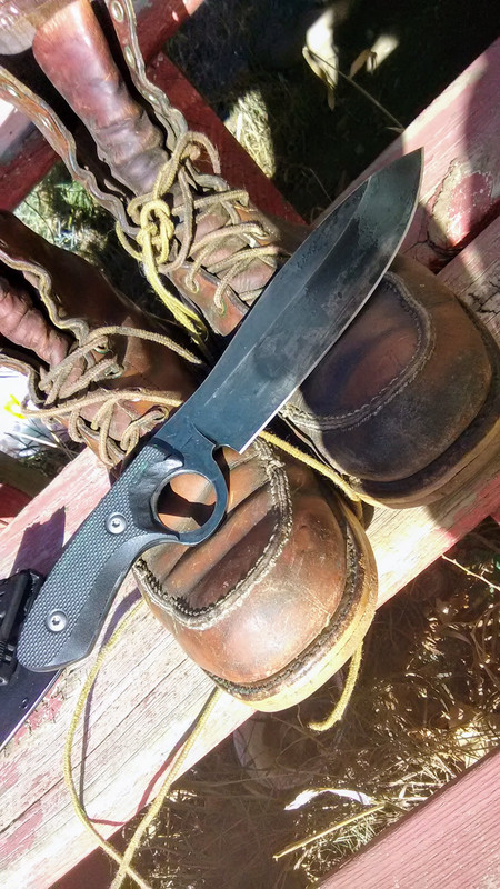

my only D2 knife is a Kizlyar Supreme Sensei and the other day i noticed some scratches near the tip. At first i was worried it was a fracture because it ran from near the tip to the edge and i can feel it with my finger nail. I sharpened it and the scratches on the edge came out. Is this normal? I have heard allot about d2 being brittle, in which case it would just snap right? I noticed the scratches near the tip after stabbing it into a tree stump to make some feather sticks. I tried the same action again and noticed more scratches. Is that enough to make scratches on D2?
Of course I have had other knives in other steels that have scratched but i dont think ive ever been able to feel them catch my finger nail.
The scratches arent on the other side
Pretty sure the stump is just fir.

D2 is fairly decent in the wear and tear resistance dept, but it will scratch if it makes contact with an abrasive surface. I have seen a Benchmade 710 scratched so bad it looked like someone wiped it down with sandpaper.
D2 has been used in tools and knives for generations. Something tells me if it were really that brittle and likely to break, it would have gone the way of the dodo decades ago.
Is it possible there is some sand, or pebbles, or other gritty stuff on the surface of that wood? It might be a silicate scratching the blade rather than the wood itself.
yeah, it scratches because silica particles (silicon) tends to be everywhere, even in trees. The only way to minimize scratches is if your blade hardness is up around 65+...

also somewhat common is quartz, which unfortunately has mohs hardness of 7... to avoid scratching those you might need @Ban to make you something out of zdp-189 or something crazy

And D dirc i dont care about the scratches, just worried me how deep they are and that they went all of the way out to the edge. I believe in using tools and love the way they wear.
Something else to consider, your blade may have came in contact with small steel fragments that chipped of the chainsaw chain when cutting the tree down.
If you do a search there was a recent thread on Kizlyar Supreme being very bad knives. It's probably not d2 and probably not a good heat treatment.
it might be because some Chinese mfgs use this 'type' of d2 - http://www.zknives.com/knives/steels/EST/ytl122.shtml
which isn't really d2, since it has around 0.2% vanadium instead of 1%, and the other variances are rather loose at best...
I hope the better Chinese makers don't touch this stuff
Whereas Kizlyar [not Kizlyar Supreme] make rather good knives in my experience.
