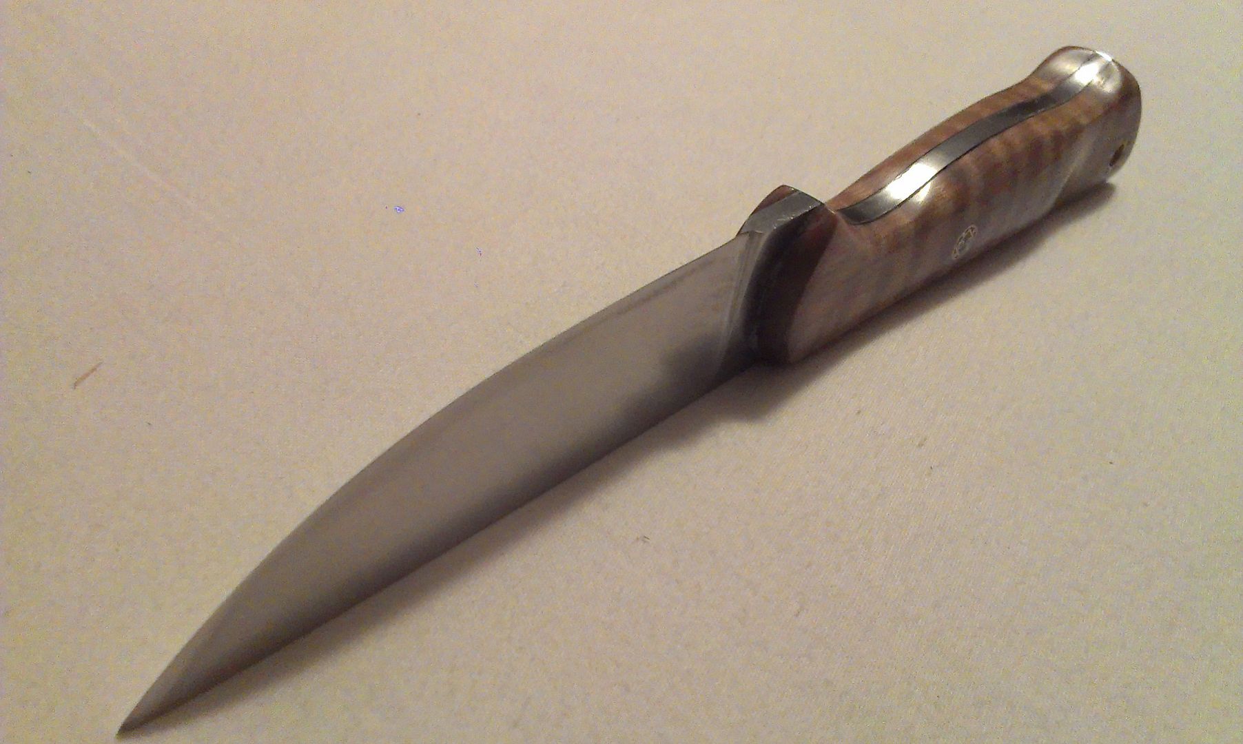

I'm going to try to polish my knife in d2 to a full orange peel finish then give it some FC acid. Hopefully it will come out nicely because that will be a lot(!) of work. A lot of work that could quickly be undone with acid. :o
This is the knife.
I'll have to do the full tang of course,but I'm not sure how. Any suggestions?
Maybe a q-tip soaked in the acid? I'd rather keep it from getting under the scales. Does FC interact with CA (super) glue?
several options,if you want it to look clean you'll need the etch to reach all the way to the scales or keep the ricasso polished. what i'd do is either apply carefully whith a q tip or mask the scales at the ricasso then refinish there. or you can find an adequate container put the knife securely in and fill with acid carefully until it reaches the ricasso but not yetthe scales and then polish the ricasso and spine to get it clean.
i'm affraid the etched blade and polished ricasso and spine will look weird but i'd be worried about the acid going under the scales by capillarity. dont know how it reacts with epoxy and CA as i've always avoided contact. someone who knows may chime in.
Right, I'm in agreement. I wonder if there is a neutralizer that could be used after treatment just in case the acid does get under the scales. Not sure, maybe baking soda? I can fill any potential gaps with CA, but I'll need to know if there will be an interaction first. If nobody knows I suppose I could CA treat a piece of wood and test it out.
Man I wish I could go back in time and use FC before I made and installed the scales. :)
just a general advice before someone answers regarding FC and CA/epoxy (you epoxyed the scales right ?), for revealing steel structures, the more polished the blade is the crispier the "pattern" or details will be, thats why i polished my blade up to 5k naniwa SS before etching.
baking soda neutralises FC for sure thats what i use, not sure if it will be enough if the acids creeps under the scales.
Etching the tang on a finished knife is asking for big problems. If you're super careful you might get away with it, but there's a good chance you'll ruin the seal and end up rebuilding the handle. It depends on the etchant and the epoxy/CA whatever... there's really only one way to find out :D
When I etch blades, I either do the entire thing before building the handle, or just etch the flats and polish the spine/tang edges.
