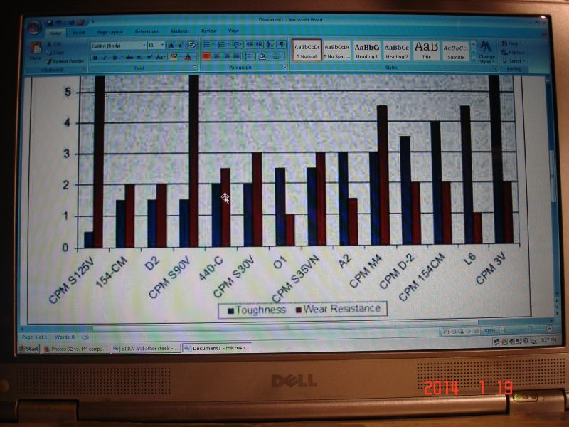

Where did you read that CPM D2 is tougher than CPM M4 and tougher than D2?
I saved a graph to my computer for quick reference, but didn't save the source. Here's a screen shot of my computer.
I would like to know where that came from, and more in general about how that info was tabulated. I don't think I have ever seen a bigger jump in any category that high just from the PM process. That graph with its unit-less numbers is saying that CPM D2 is more than twice as tough as D2. I don't buy that. Not questioning you, but that looks like a very vague chart that I would not trust. It should give some units, and have some explanation as to what it means, and how and what method the results were obtained. There are very scientific tests that are done to get numbers and comparisons.
*Just noticed that the idiot (yes, I am now calling him an idiot, and not just questioning the accuracy) that made the chart has "CPM 154CM" listed as a steel. That is not a steel made, and the credibility, what little was there, is now gone. Plus it is shown as tougher than CPM M4 and CPM D2. I highly doubt that. I would't trust or use that chart to base any information off of moving forward.
I appreciate you backing up your claims, I was not trying to bash you, just legitimately curious as something sounded fishy.
Yes, you're making good points. Thanks for that. I wish I remembered where I got that chart.
Here's one directly from Crucible:
http://www.crucible.com/pdfs/SelectorKnifePocketRotatedCrucibleLLC.pdf
The scales are different than the chart I posted, but the basic information is roughly the same, but not entirely. Crucible shows that CPM M4 is much more wear resistant and tougher than D2, but CPM D2 is equally as tough as M4, though not as wear resistant.
154 Cm is less wear resistant and less tough than CPM 154.
