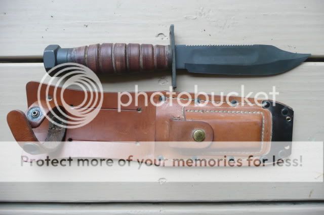

I have a knife that looks a lot like this, that a friend gave to me. I cant wait to see what this could look like with a nice restore done.
human1ess, I believe your knife may be a "pilot's knife". I recently purchased one at the local gun show in very nice condition.
Good on you for fixing up that mk2, looks like it has a lot of character in it for sure!
That makes sense, he's in the air force.
That would be a pilots survival knife, commonly made by ontario but I think camillus made them at some point also. Ontario actually still produces them, handy knives.
