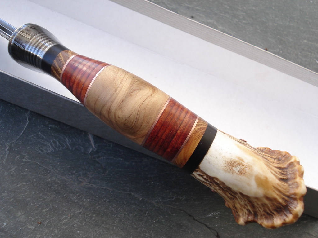

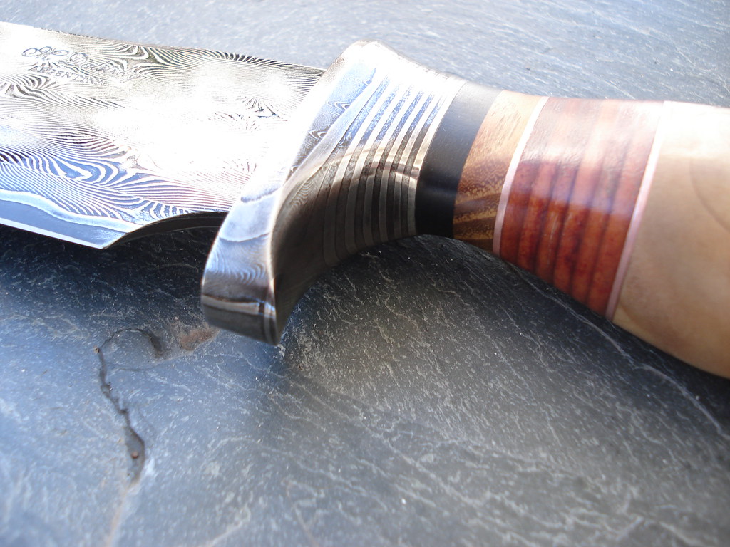

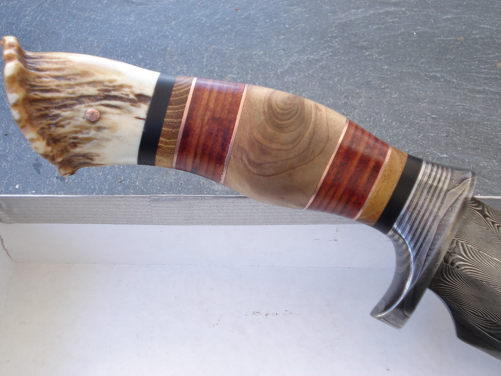

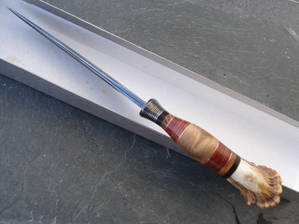

this is a damascus colaboration scagel where the blade was made by Mauricio Daletzky and the handle by Juan Gabriel Rossi.

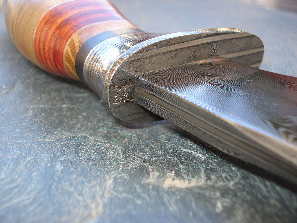

the blade is a san mai with a series of seven twisted bars of 1010 and 1070 on the outside, separated from the core of 52100 by a thin layer of 15n20 to add some contrast.
the guard was made from the same materials and similar pattern
on the handle we have: ebony,maclura,copper, leather,copper, pine root, then the same secuence and finally staghorn. all sealed up with epoxi and fixed by a copper pin.
blade length 8"
thickness 8 mm

Wow, I really like that. Outstanding damascus work - great symmetry and control evident in those patterns. The knife looks like a lot of fun to swing around too. And great leatherwork too!
