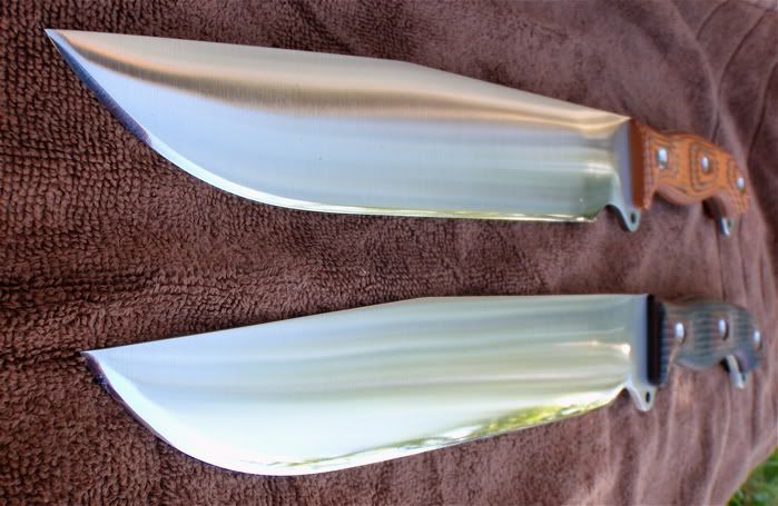

Okay Hogs, can I have some advice here? I was out in the woods with my user BWM yesterday chopping on some logs and generally having fun. When I came in I noticed that I had chipped out the edge near the tip of the blade. I tried to be careful with what I was chopping, but apparently I missed the mark at some point. My question is- what's the best way to fix this damage? More specifically, to smooth all the chips out looks like it's going to require some fairly major work. Am I overestimating the damage here?

Your looks more like rolls than chips.
Best way to start is with a smooth steel, a screwdriver shaft is a suitable stand-in.
Steel out the damage first, pushing the damage back to the edge to reform it, then sharpen as usual to clean up any residual.
That looks minor:) I would straighten the edge out with a steel and lightly sharpen it out too.
Looks like the thinnest part of the edge dented or rolled a little.

That is the first time I think I have seen a chip in INFI wow congrats. Like the others say I would just try to use a steel or other smooth hard steel surface to force the rolls back into place. Then sharpen out the light chips and you are good to go.

+1 Great advice--obviously, the less steel you remove the longer the blade will last, and those little rolls won't bother a thing. I believe it was Cobalt who put a nice ding in the edge of a SHBM years ago, steeled and re-sharpened, and still had a little gap--said it cut better than ever, naming it the "single serration" effect.
