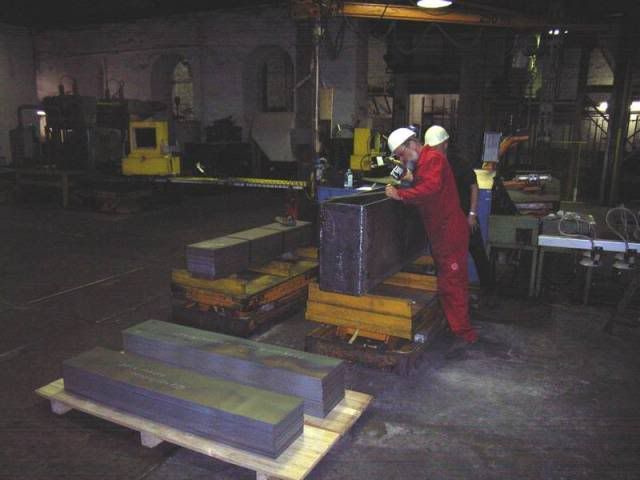

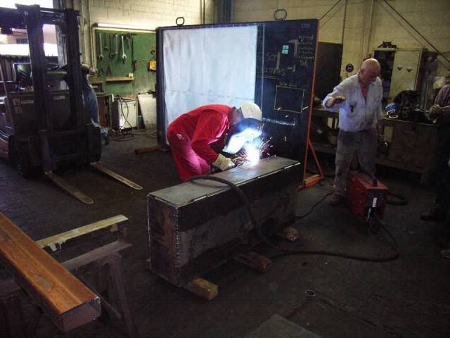

Achim Wirtz one of the best German Damastmakers and some of his friends tried to make some damast without the problems of decarbonization, welding faults aso.
put 330 layers of good german steel in a steel "box"
close the box

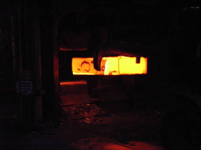

put it for 24 hours in a furnace with exact temperature control
take it out the furnace

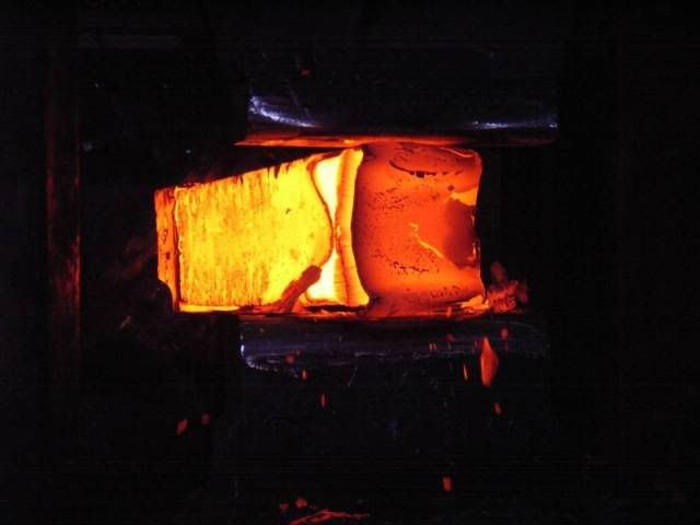

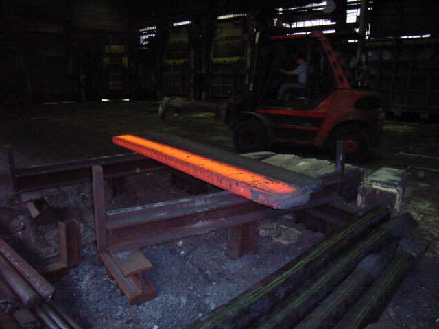

start forging with a 1000 Ton hammer pressure
this the result
a cut section of the bar

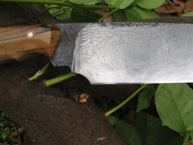

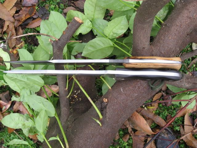

this knife was handforged from this steel and the maker tested it like all his knives with success.
That's a helluva billet!!!!!!!!! Love those big choppers and that looks to be a fantastic knife.....the Damascus looks to be superb, too.
Thanks for the pictures of the Damascus-making process. :cool:

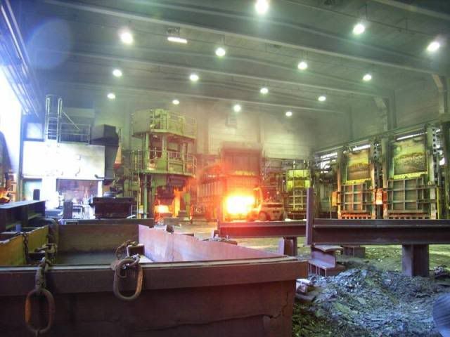

Goodness. Do they own a steel factory? Where did they get the kind of equipment to turn out such a large billet?

The steel sure looks great as the knife your friend made:thumbup:
