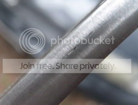

I am in the process of trying to make a damascus billet by hand. It's only 12 layers that started at 1" wide x 1 1/2" (12 x 1/8") x 3" and is now about 1 3/8" wide x 1/4" x 8".
I did half yesterday. Just to take a look, I ground the sides flat and started forging it tonight and in the first round of forging, I noticed a couple definite "shelves" as if the layers slipped. I'm guessing my initial weld didn't work but wondered if you think that's it's salvageable.
I re-fluxed (with Z-weld) and cranked up the heat to try to set it all again and hope that it takes or is it likely too late.
I thought I did everything right with heat and time and flux but wonder if I should have smacked it harder. I read that you don't need crazy force but not having done this before.... well....
I am tempted to not bother re-stacking and making a blade just to see..
Any ideas?

Clean it up good and grind down the sides.Take a wire brush or better yet a whirlybird and hit those bad spots hard. Try to get them as clean as possible. Flux the piss out of the bad spots and let it soak real good. Make sure it comes to heat all the way thru. You can probably fix those flaws...Since these flaws are in the billet start your blows little harder than you would normally start. You have to seat them together. Dont hit it like your killing a hog, but firm.
You can set a weld with a handle and no hammer. Dosnt take much at all to set it..Bad welds are most often caused by too low a temp. Hitting it to hard can sure do it too..From now on start with light blows. Like your driving a finishing nail. Tap,tap,tap...Brush, flux back in the forge..Next time a bit harder..etc..etc..
Temp is everything with welding, get the temp right and you can fix a broken heart or a hole in the sky..;)
Stuart don't give up yet buddy, Kentucky has offered some great tips.
Just like Kentucky said most problems are not hot enough or hitting to hard. Don't be afraid to let it cook a little, when I teach people to forge weld they always want to pull it to early. I always tell them when they think it is ready walk away for about 10 minutes then it is ready. The billet should be the same color as the interior of forge and no shadows when you roll the billet over in the forge.
Also work your billet from the middle out so you don't weld the edges first and trap flux in the billet. Post some pictures we can give you better advise if we can see what you have going on.
Thanks guys. I did basically what Kentucky said. I started with firm "taps" and then fluxed and reheat, a little harder still, then a third time I gave it some good solid hits with my 12lb'er one handed.
I let it cool this evening and ground the edges again and I have one spot that I now know is a problem. I can catch my fingernail in it. It's about 1" long about the middle of billet. I'm going to think about cutting and restacking and hope that one spot cures itself in the process. If not I'm sure the HT will give me a nice surprise.
I will try to be more patient with the soaks. The forge was so hot and bright that I could only look at it with sunglasses. The billet did look the same colour as the sides... hmmm... I think it's like you said Mike, if I think it's ready, I should just walk away for 10 minutes.
I lightly etched the edges to see the layers (I couldn't help myself) so I hope if any got in the fissure that it won't cause problems.
Thanks guys. Wish I could start over...
Nope won't hurt it Stuart, you could even soak it in vinegar to help break up the scale.
Pictures where are the pictures :p? Stuart let that baby cook, also make sure the flux does not cook off either and when you think it is ready go get some coffee or something. If you still have trouble come on down I would be happy to help you out.

Sorry for the delay in photos but here's a couple.
First is the fissure. I kept working on it until the billet was about 3/16" - 1/4" thick by about 8" long by about 1 1/8" wide. Never really seemed to fully resolve itself.
I decided that at those dimensions and with all the hammer marks and such that I would restack and try welding again and if it cured the fissure, great!

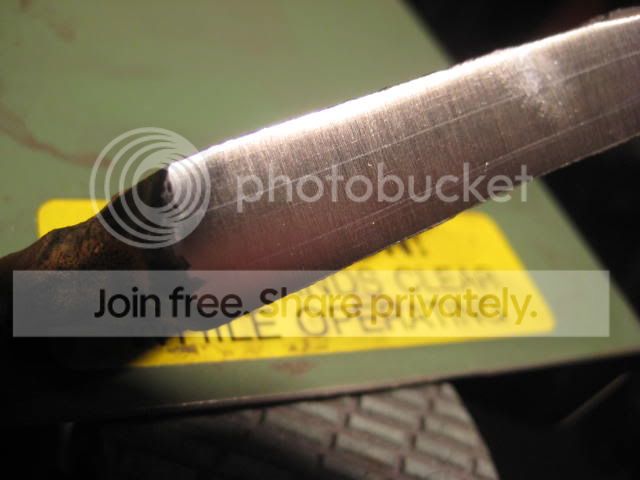

So I did as Page's post recommended; single tap, re flux and back into the forge. I did about 5 heats, increasing the number of blows but not really hitting any harder.

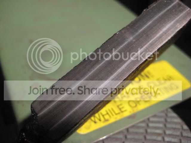

I let it cool and ground the edges clean to see what happened. It looks nice except I can clearly see the 3 layers I cut the billet into.
Now, I don't have a surface grinder but I cleaned up the pieces really well. I could still see light between them when I stacked them and tack welded them together. I fluxed like mad to prevent anything getting on my nice clean surfaces.
But after a quick etch you can really see where the layers are. I'm hoping further forging will get rid of that. I have the piece soaking in vinegar just in case and will forge this into a blade tomorrow night. It's supposed be 36 layers now but i must have ground off or burned off some. There certainly doesn't look like 36 there.
What's going on here?
