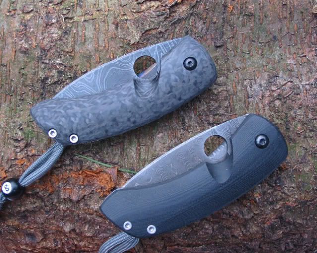

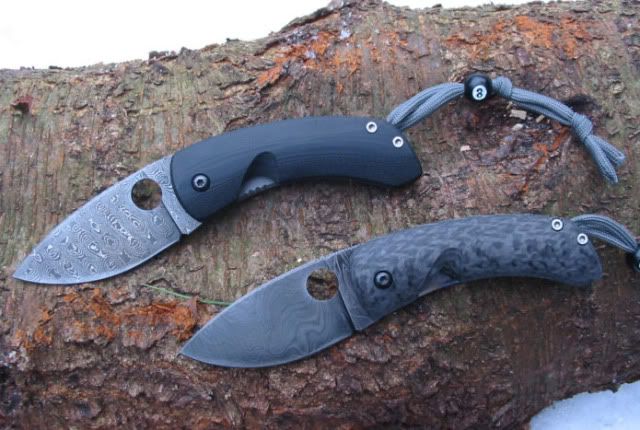

Got these two Damascus Chinese Framelock folders.
Blade is 3 inch
Overall lenght: 6.5 inch

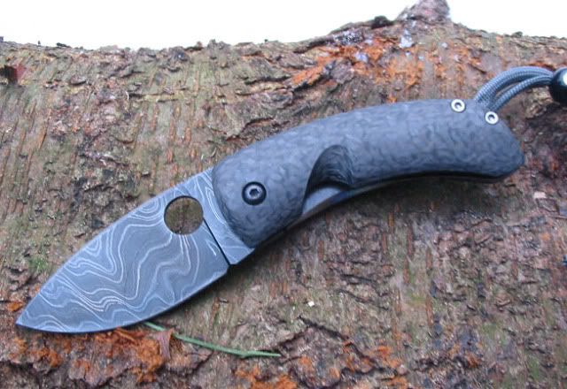

Top one is Chad Nichols damascus, black G10 with a beadblast finish.
Bottom one is Alabama damascus ( 52100, 5160, 203E, and 15N20) , with a carbon fiber handle.
Framelocks off course, with a custom titanium pocket clip and a lanyard hole.
The lanyard hole isn't visible on the front side of the knife.

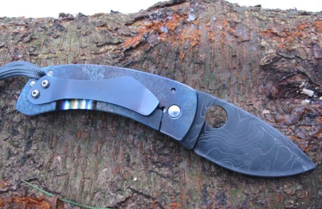

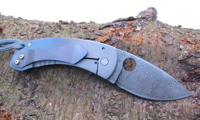

I tried something new on the backside. I didn't clean up the titanium this time. It's still in it's rough shape. I only anodized it with a propane torch.

That's a first for me... how does one anodize metal with a torch?
"I only anodized it with a propane torch."
You just use the heat of the flame to color the titanium. First, it turns to yellow, then purple, then blue,...
Is that stainless damascus? I have a damascus knife and the colors went out after I used it. Mustr have reacted to something I cut it with. Will yours still look like what it does now after use? Thanks.
It's Carbon damascus.
The pattern may fade a little bit with use, but you can always re-etch the blade again so that it looks like new. No problem at all.
