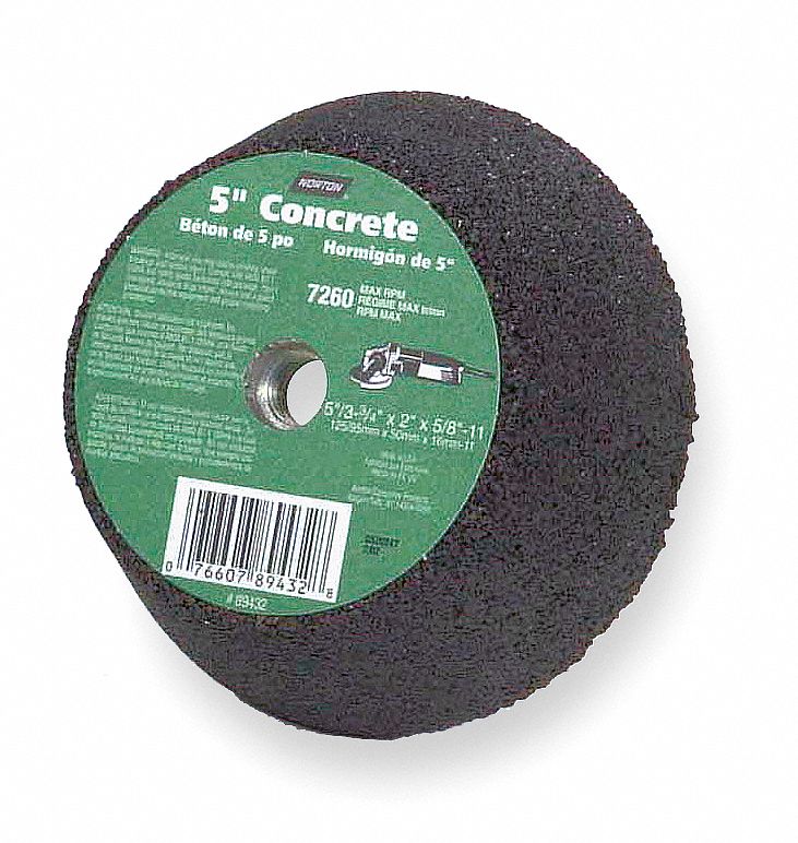

Do you have access to a 7 1/2 inch right angle grinder and a cup stone?
6A080_AS01
They work like magic to surface the billet and they save you a lot of money in belts.
6A080_AS01

Where do you get hydrocarbon solvent? I do have a large right angle grinder so that definitely would save on belts and i normally forge the bar out to 1/4" thick and cut into 3-4 pieces.
