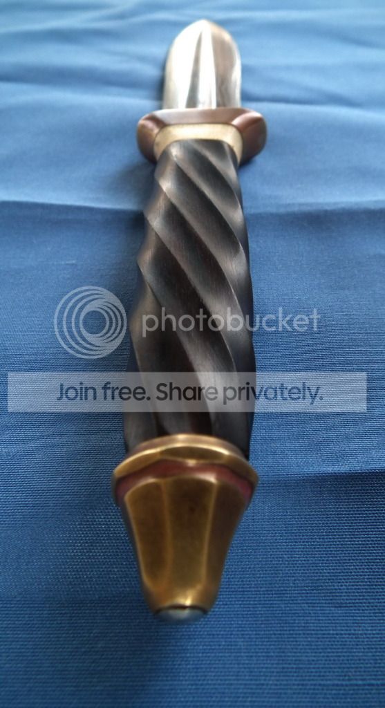

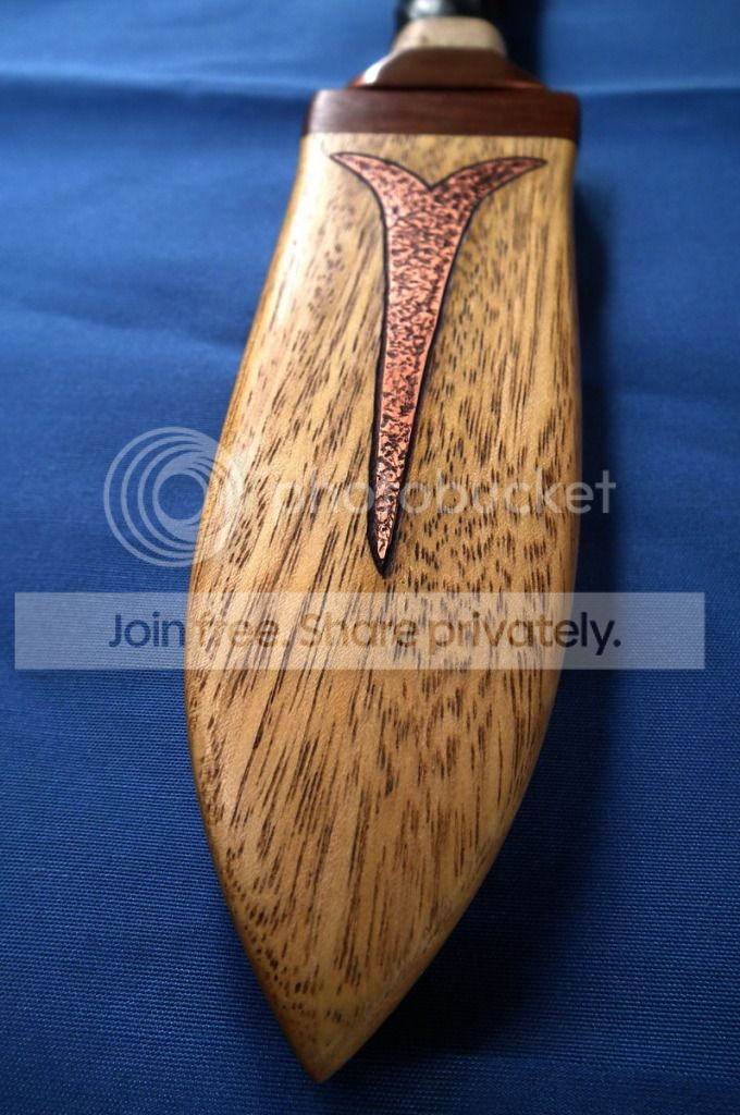

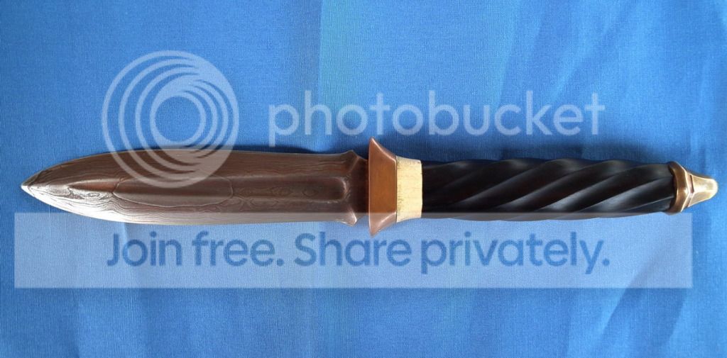

1095 and 52100 steel combination Damascus. Handle is ebony and maple. Total length 250 mm, thickness 5 mm, blade 125 mm. Bolster is brass and copper.

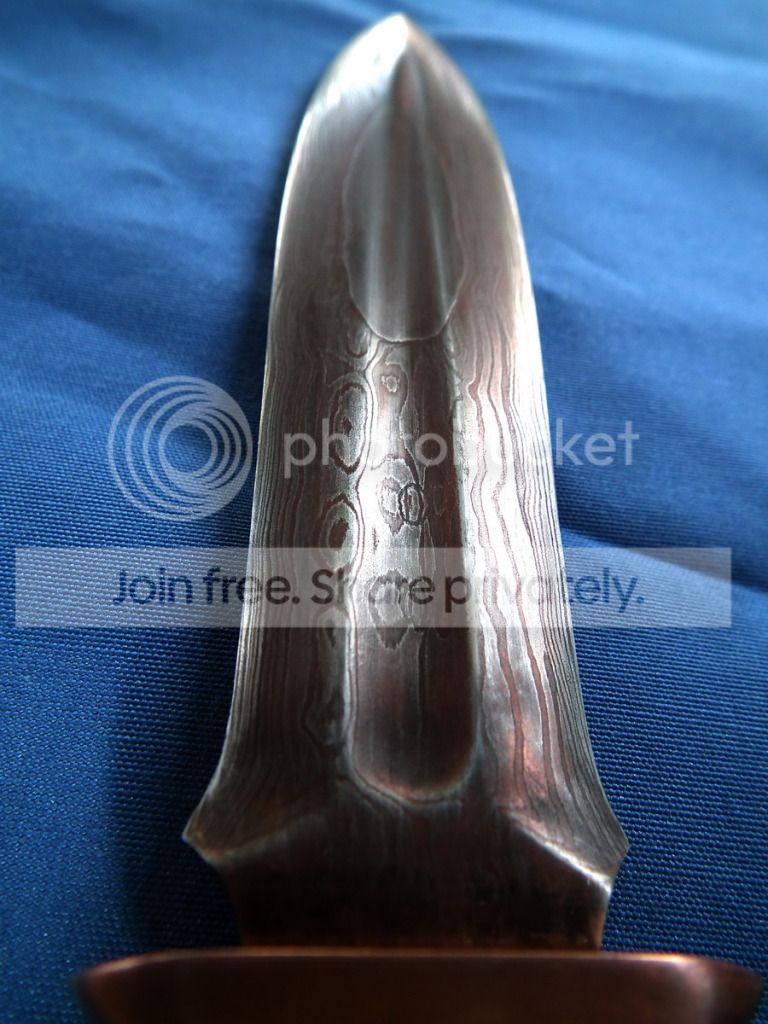

Pretty. Two constructive criticisms... the edges of the fullered center are not as sharp as they could be. I'm thinking you need a more rigis sanding block to resolve that. Also, i can see a pretty sharp line of demarcation between the guard and the maple part of the handle. You could sand down down more and get a smoother join.
Still, gotta say it's a very nice looking dagger.

Did you make the Billet? The Blade? Both? The unetched oval in the middle is rather distracting. There is something that is wrong there. Maybe just a bad etch?
Thanks for comment Stacy. It isn't bad etch, oval in the middle is only ball bearing. What is "the billet", I don't understand sorry :confused:
Sefa
Ahh, a ball bearing, OK.
The billet is the stack of metal layers you hammer into a bar. The finished bar is called a billet,too.
