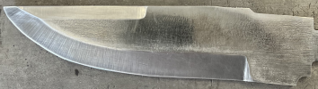

So I forged welded a billet using 15N20 and 1084. I ended up with 304 layers and cut in an X ladder pattern on the final billet. Completed the knife, sanded, soaked in acid and no pattern appears. WHAT???? I guess the only thing that could have happened is I accidentally used the same metal, which I staggered... lol. I just don't think I did that. I even remember seeing the different metals when welding the corners. I'm at a complete loss and wasted many hours to get nothing in the end. Is there any other possibility that I may be overlooking? Any help is appreciated....Thank you!
Well I can’t figure out how to get the pic in here…. Just imagine a piece of metal with no pattern
Where did you get the steel? both new steels and not recycled? What acid are you etching in? How did you harden the piece and did you confirm it’s hardened even just a simple file test? What grit are you at on your finish? How long are you soaking in acid? Is anything happening when you dunk in acid or is it staying bright? So many variables and like Hoss asked a picture would help, without a membership you’ll need to use a hosting site, you can find sticky’s pinned at the top of this subforurm that walk you through how to post photos
It’s new steel, not recycled. Ferric chloride and vinegar. It’s hard based on file test. Finished sanding at 3000. It turns blackish after acid…
Dilute your ferric chloride to a little less than real maple syrup in looks, sand to fresh 600 grit, re-etch and see what happens. Submerge billet in FC for 15 minutes. All pattern welded damascus needs to be fully tempered.

With how many layers of steel did you start ? And what thickness were they ? Maybe you end up with mono steel :)

OK, I will need to get some more FC. So I tempered at 375 degrees for 1 hour, two cycles..... would that be appropriate?

I saw your website. You show 400 degrees for your carbon steel tempering. I'm afraid I may have gotten some bad 15N20. It was cheaper than most other sites and came gray looking in color.

The things that make the pattern show are:
1) Ferric Chloride strength and freshness. - If it is old or diluted with something that reacts with it, it may not etch well or take a long time. I recommend using stock FC solution and water diluted 1:3 (FC:Water). I have not had the best results with vinegar as the dilutant. I prefer to mix it from dehydrated powder or chunks bought from eBay or other sites.
2) Metal condition - The steel must be sanded to around 400-600 grit for the best results and must be absolutely clean. Degrease it with acetone then was well with Dawn or Simple Green. Rinse with hot water well and do not touch it any more than necessary. Immediately place in the etch tank.
3) Time - FC may make the surface black in a short time, but takes longer to eat away the steel layers to form a pattern. Sometimes it can take 30 minutes or longer to get a good etch. Take the blade out every 3-5 minutes and rinse it with a garden hose, wipe it off with a clean paper towel, rinse again and place back in the FC tank. Check again in 3-5 minutes.
4) Tank size. You want a sufficient volume of FC to do the task. A gallon is the minimum. A piece of 4" PVC pipe with a closed closet fitting or closet flange fitting for the bottom and a cap for the top (to cover it when not in use) makes a great tank. 16" is plenty deep enough for most blades. Use good grade PVC cement when sealing the bottom to the tube. You just slip the top cap on loosely to cover it when not in use.
5) Temperature. FC works best at normal room temp. Around 70°F/21°C is perfect. In practice, 60-90°F/15-32°C is fine. Too hot or too cold may affect the action.

Stacy,
That is a heck of an explanation! Thank you.... this is more than helpful. I can also verify that FC will stain concrete.... (don't ask me how I know) 😒
The pattern is there. It just needs a longer and deeper etch. You also need to sand it more and better.
With those big flat areas with all the pits and scratches you are going to have a hard time seeing any pattern. all those areas should be at least a clean 400 grit finish.
Yes sir… I addressed those areas. Typically I have seen a pattern when heat treating… this one I saw nothing. So I ground in an edge and tried the acid bath before I put anymore time into this knife. Still nothing so I stopped working on it and came here for advice. This is only my 4th Damascus and never ran into this issue.
patterns there like Stacy said. I can see layers and the welding flaws.
Improper cleaning of blade before etching might be interfering with etch
About half way from plunge is a black line that either an incomplete weld or inclusion. Further towards the tip are a couple more. Someone with more experience and better eyes might explain better.
