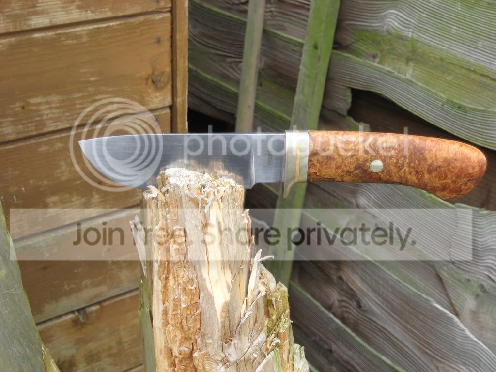

I have been making knives seriously for 3 years now and have just completed my first damascus blade. Nothing fancy, just 9 layers of different saw blades. (I'll post a picture when its finished, once Ive worked out how to!)
The blade is finished ready for the guard to be fitted, but I'm not sure whether to etch then solder the guard on or vice versa.
Some advice would be greatly appreciated.
Ian.
Is the guard damascus also? what shape guard are you going to use? What I would suggest is, fitting the guard, handle , etc to the blade , take to final shape and finish, then remove, etch blade, and guard and attach using JB weld, attaching the handle at the same time keeps everything where its suppose to be, use several pins holding the parts in palce, this way it will slide together properly. All this takes more time and patience but it will look cleaner when finished. JMO.

In reply to B. Buxton, the guard is single and made of 1/4" brass. (I prefer
3/8" but my blade is only 2 3/4" due to not making the billet big enough!!
live and learn eh?)
My main concern was whether the heat/clean up from the solder would spoil the etch, or if done the other way round, the ferric chloride would spoil the guard joint.
I'm normally a stock removal man and this is only my second forged blade, so damascus is a rather big step for me.

JB weld is a 2 part liquid metal that you mix like all 2 part epoxies.
Since your using brass and soldering, I'd go ahead and solder the guard material in place, finish sanding the face of the brass first, there are some solders that ferric chloride will attack pretty aggressively, just be aware of that. once you have the brass soldered in place and cleaned up, coat the brass using fingernail polish, then when you etch the blade it will protect the brass from the etchant.

I took your advice with the nail polish, it worked a treat.
