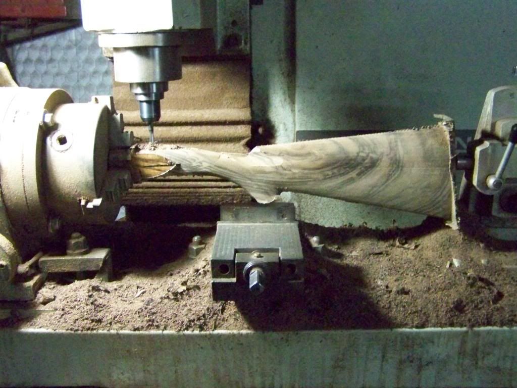

The last two days have been spent making wood shaving and dust. I changed a few features on my CAD program for my stocks since I made my prototype, so I had to prove the programing, and I certainly wasn't going to put an exhibition English blank on the machine and test my work. I have a few blanks on han dso I picked one that is nice, but wouldn't fill me with remorse if all went South. As it turns out, the stock had some nice figure hiding in there. Here it is, almost finished machining the action inletting.

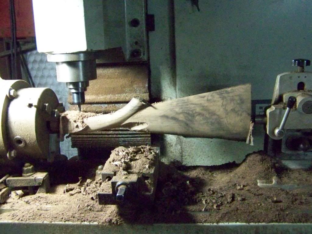

Since the program was good, time for the real blank to go under the cutter.

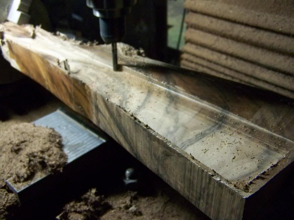

And a shot during the final stage of inletting the top side of the action.
The inletting is not machined close enough to fit the action. I just get a good start on the cavity and it ensures alighnment.

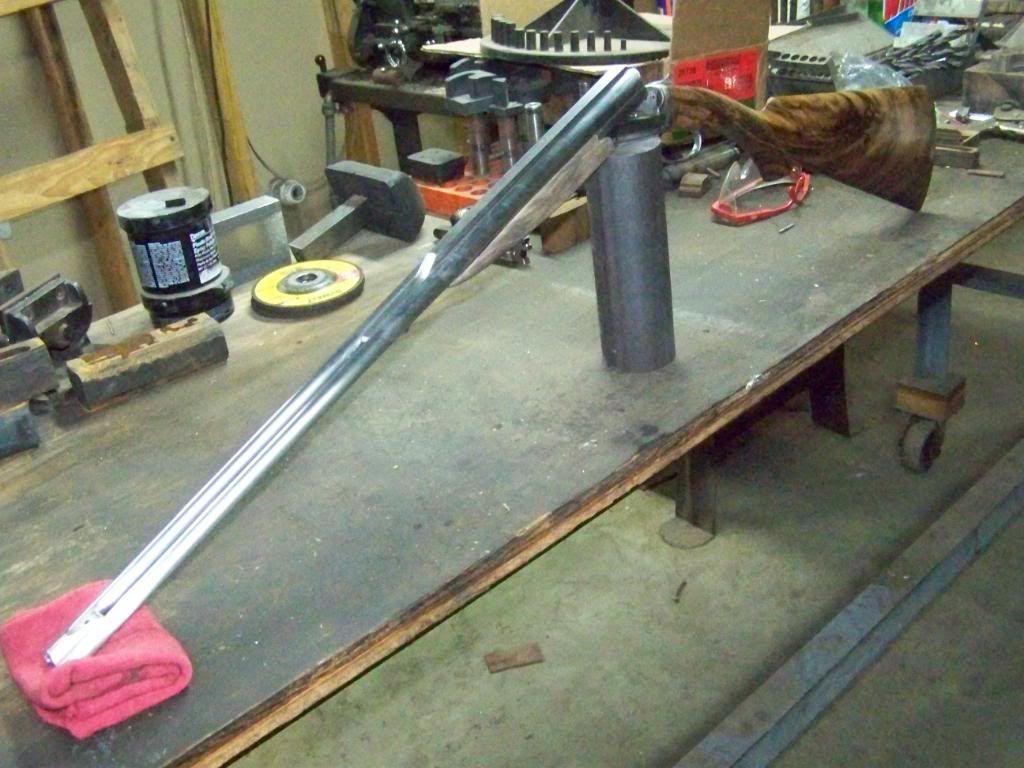

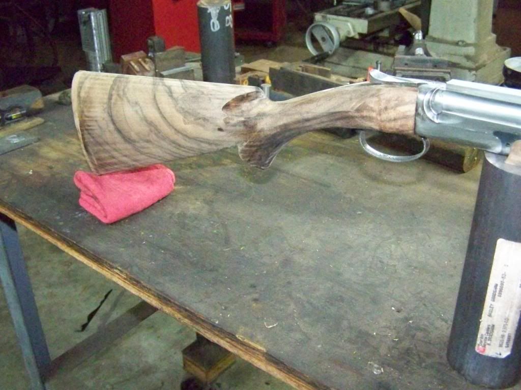

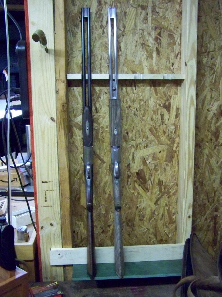

This stage always gets me excited. It's that first feel with the stock that reveals so much time and effort. I must say, this one will be hard to see go. It feels great, fits me at the moment ( it will be too short at it's final length of pull)and due to the heavier wood, balances better than my prototype. Nothing like good, dense English walnut. Hope you enjoy!!
Two of a kind...
Two of a kind...

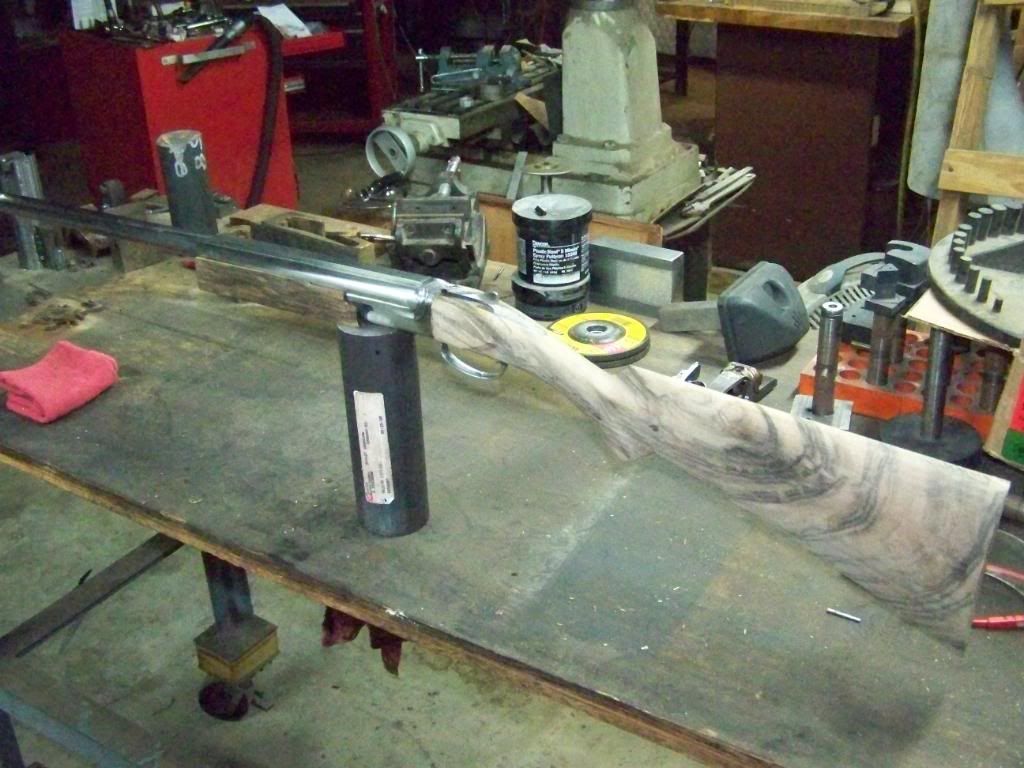

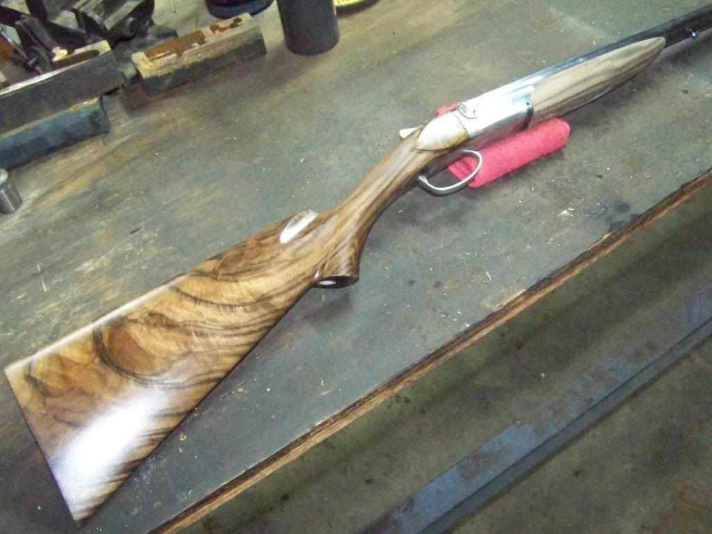

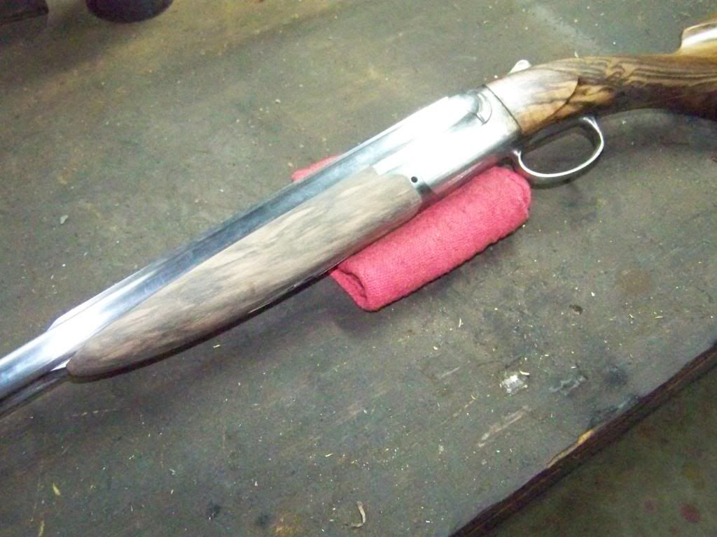

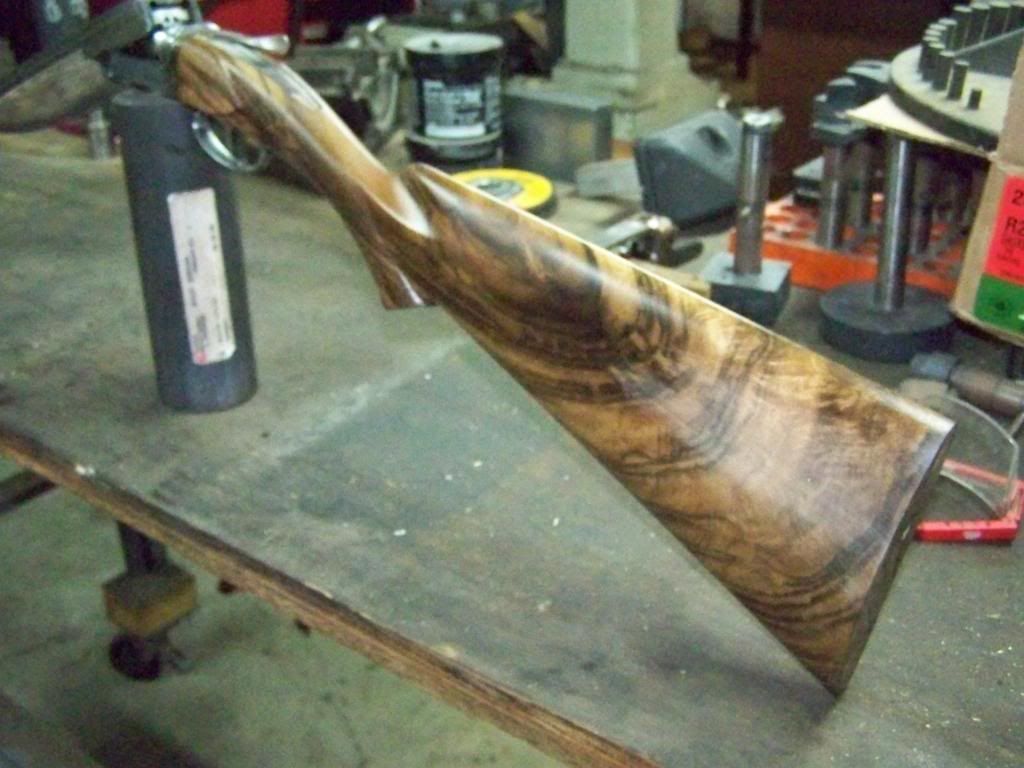

Shaped the forend wood and sanded the stock to 320. Also have the first couple coats of finish on. I use Permalin to finish my stocks. I like both the sealer and finish. I start by applying a few coats of sealer until it stops soaking in, then follow with a thick coat of finish. Let it dry for a ferw hours, then wet-sand the surface buildup off. Recoat and repeat until the pores are all filled. This stock will only take two rounds as the pores are so small to begin with. From there, I can use a couple of methods depending on the level of sheen desired.
Anyway, here are a few pics....
