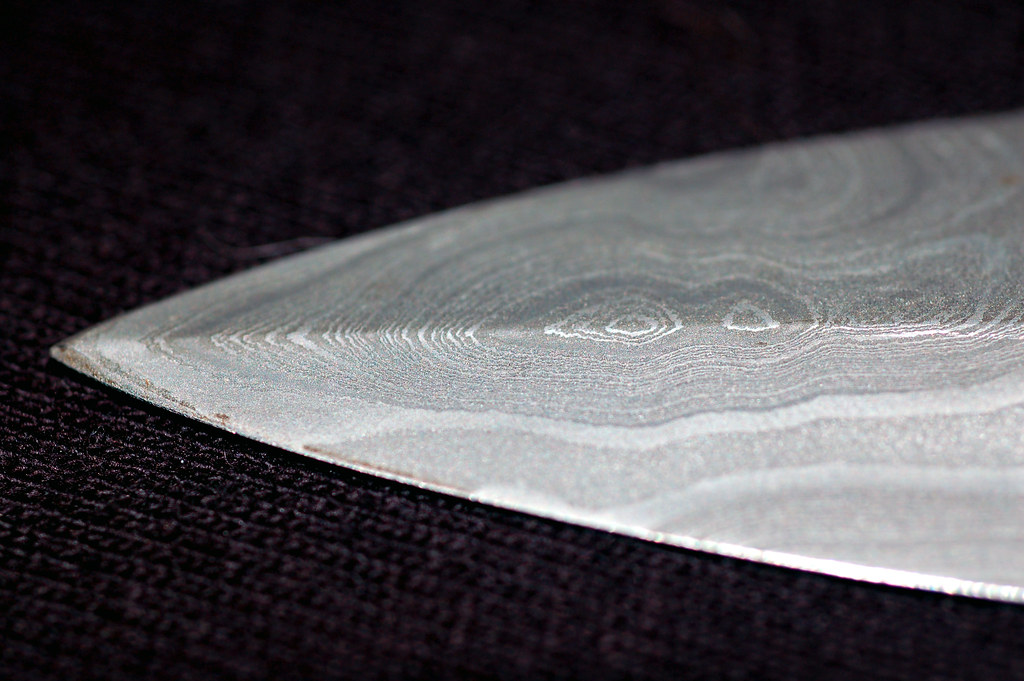

What kind of steel is Damascus? Is it crap steel with nice patterns or is it a better steel than S30V, D2 or 154CM? Could I buy a Damascus folder to be a great user or is it just eye candy?

Damascus steel is not one particular steel. As I understand it, damascus today refers to folded or laminated steel. The pattern comes from the different layers of steel, sometimes hundreds. You could certainly us a damascus folder for a user, assuming that: It is made of good steel and properly heat treated. Is there any particular folder you are looking at?

Depends on the damascus. A cheap chinese damascus blade is not made of the same stuff as a 14th century Iranian saber. It's a very, very old technology, and there's a huge variety of different styles and qualities.
There are damascus blades that would make great users, just like there are regular or powder steel blades that would make great users. There are also damascus blades that would make god-awful users.
There are lots of different damascus steels. Some are high carbon, some are stainless, and some are hybrids. I have a Mcusta with a VG10 core and multiple layers of a stainless over it. The steel is going to cut like the VG10 core.
Some Damascus is going to be very high quality, but some of the cheaper stuff is not - it is not good stuff.
Damascus is now intended to be pretty. Originally, it was designed to increase the toughness of steel by bonding a mix of hard and soft steel. This was aimed at providing a steel with good edge retention with a tougher steel mixed in. Now, it is mainly used as a decorative option.

You're pretty-much right except laminated steels are different from damascus. Laminated steels are typically composed of an inner core of hard but brittle steel sandwiched between milder steel. The center steel retains a sharp edge while the outer layers give it strength & flexibility.
Most modern Damascus is pattern-welded and is composed of many layers of at least 2 different types of steel. There are many suppliers of damascus and the quality will differ greatly.

That excerpt from the wikipedia article is incorrect. Watered steel/damascus/bulat/wootz is made by several people around the world today.
What we typically call damascus is pattern welded steel. Take multiple pieces of steel (and some other metals on occasion), in plate, wires, chain, powder, etc, and forge them together. Depending on how the billet is manipulated in forging, different patterns will form. These patterns are brought out through surface finishing and etching.
The whole process is for aesthetics, just as we like stag, burl wood, timascus, mokume, etc to embellish our knives. The steel should perform well, but pattern welding does not offer inherent advantages to unmixed modern steels.

Original Damascus was made, I think, in India and the cultural areas adjoining it and it was a steel with a very prominent grain caused by the distribution of carbides. Wootz, which is made today is pretty similar.
If you can get your hands on a Roselli UHC you will see a type of Wootz steel. The grain is just crazy to see and the color of the steel, even on the ground bevel is a very dark gray.
At any rate, modern decorative Damascus is just that, decorative. I'll take a nice patina on a carbon blade or a good high end stainless...like CPM 3V or 30V or 90V or something like that any day. Or for that matter a nice blade in Sandvik 12c27 (if I have the nomenclature correct) or VG-10. All great steel that should probably out perform modern Damascus.

depends on the damascus. i have one knife with it (kershaw shallot) and it is comprised of 52100 and 5160. in other words its good stuff :thumbup:
William Henry offers laminated blades with a ZDP-189 core surrounded by stainless Damascus. You get the look of Damascus with the performance of a supersteel. I have stainless and Carbon Damascus blades and am underwhelmed by their edge holding abilities.

Before todays super steels, no, not just for looks. Today...just looks, especially the high contrast stuff that uses metal not usually seen in cutlery.
For even more fun, ask the mfg what the rockwell hardness is on their damascus blades. ;)
