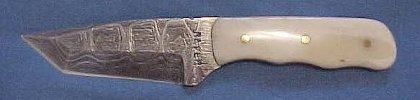

Here is a photo of my Damascus Bowie and Hunting slip joint folder set that was made in Pakistan. The Bowie blade is 7 1/8" long and the folder blade is 3 3/4" long. I don't remember how many layers they were supposed to be but they are supposed to be the same. There is no writing or anything on the blades. My Tsubosan files tests them at 50-55Rc. I think they are pretty so I'm keeping them.
