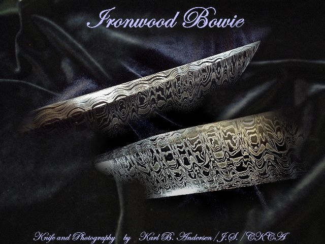

Don Fogg was the first to try the pattern posted at the bottom. He did it without the flat spacer. If you start with a single stack on edge and forge and fold it, it turns into "w's". Don twisted the first one and came up with a firestorm or an explosion pattern.
Mike Norris does a variation like the bottom stack for his hornets nest pattern.

What you are showing is the basic platform for what is referred to as "Ws", which is made by making multiple layers and crushing on edge.

Plus you need a minimum number of layers before you W. Don, how many did that billet have before you flipped it?

Joe, if I remember right it was 20 layers before the flip. I usually do anywhere between 15 to 40 layers.
The couple that I have done have been like 33 an that worked well for tiling. The ladder appears like you don't have it get as crazy with the number of cuts and rewelds you do after you flip to get something you would use for mosaic. Is that correct?

This guy has forgot more about making damascus than most of us will ever know.

I made a handful of knives from W's, but they had a slow twist or were tiled. Interesting stuff. I need to get some more dies for my press.
Ok I got that mixed up. So I should start the "W" process after I fold it once to 32 layers, and then proceed as normal?
