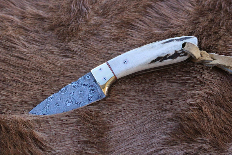

I make small knives for the most part but I usually get 7-8 blades out of one of their billets. I'm currently working on a bowie (13" oal) which is a big blade for me and I got 4 other blades out of that billet in range from 7"oal to 5.25". Their billets are pretty wide at 3". Jantz sells their 1/8" billets for $129.00. The advantage to buying directly from the good folks (and they are) at AD is that their website shows the individual piece. This comes in handy so your customer can pic a piece if they are particular about the pattern. Like this chef's knife. I emailed the customer several links from their website and this is the bllet he picked. So made this big chef's knife for him, a Santuko for my wife, 2 of these little guys in the second pic which I sold, and one of the third pic which I kept for myself. This billet was closer to 18" if I remember, so was a little more pricey than what I get from Jantz usually but the two little stag handled knives made up for it. Plus made a little knife for myself which I hadn't done in years.
Putting all these knife shapes on one piece of steel can lead to some colorful lanquage while at the bandsaw but it can be done to maximize your yield out of a billet.
