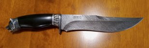

I acquired my only two Damascus steel knives very recently, both of them being of Russian origin. There was no information that I could find about the steels used to make either one of them.
This one was made by Nord Crown, (a knife art studio), in St. Petersburg Russia...
And this one by Kizlyar of Dagastan Russia...
Neither of them were exactly bargain bin priced items, but doubt that either one is made with any type of modern exotic/super steels.
I find them both to be things of beauty, which above all, seems to be the purpose of getting knives in Damascus in today's world that has so many super mono steels 😊
