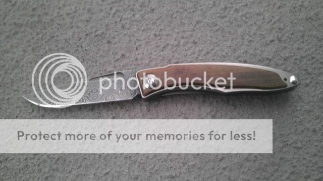

And if I might add, (IMHO) Modern Damascus in addition to looking beautiful, can be a VERY good steal, and suitable for EDC. Maybe it's not up to the super steels, but each batch is made in small quantities, and nearly every batch is different so there is rarely statistically significant testing of modern Damascus. I rotate a Stainless Damascus Mnadi, S35 Large Sebenza, S30V small Sebenza and assorted benchmades, spyderco's and Kershaws for everyday tasks, depending on what I think my needs might be.
This particular Damascus uses 304 (as I recall) stainless as one of the steels and AEB-L which is a Swedish razor blade steel as the other alloy.
The Mnandi might not be up to the super steels (or maybe it is) but it ain't bad.
