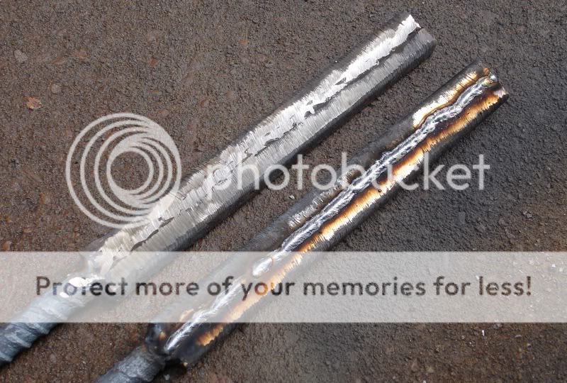

The two pairs of 9-bar billets are "Zippered" together with a MIG welder, to form an airtight "box" for welding.This eliminates flux trapping, and gives a much cleaner weld.
Excess MIG weld is ground off, as on the left-hand billet, to reduce the amount pounded into the billet when forge welding. Since the pattern will be in the center third of the finished 4-bar billet, all MIG weld will be ground off as the blade is ground.

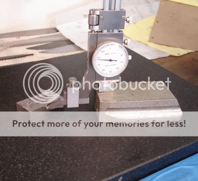

The granite plate and height gage allow marking thickness on damascus pieces for the collars. This same method was used to mark the profiled blade billet for thickness grinding.
