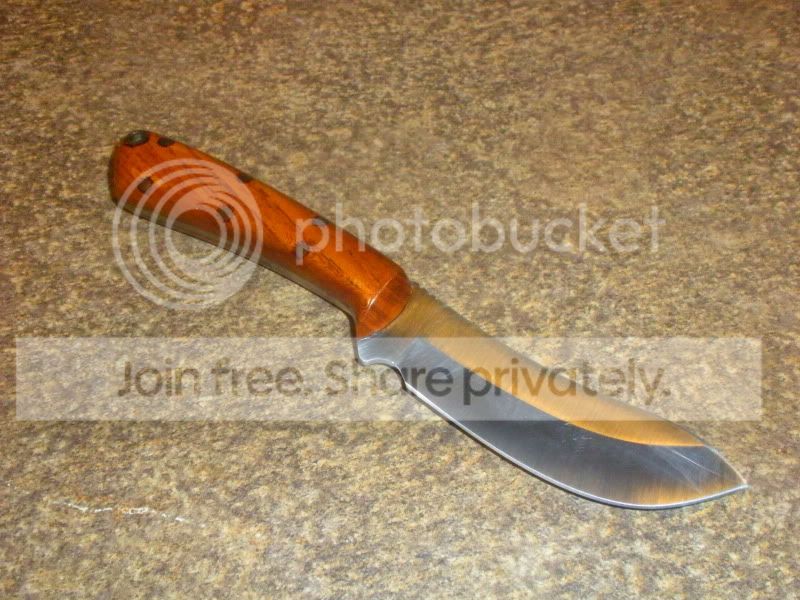

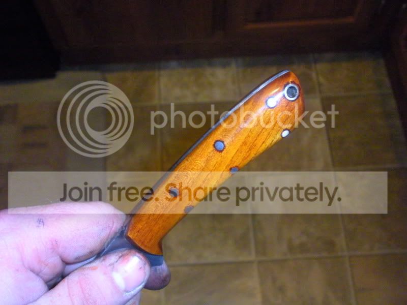

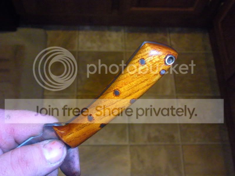

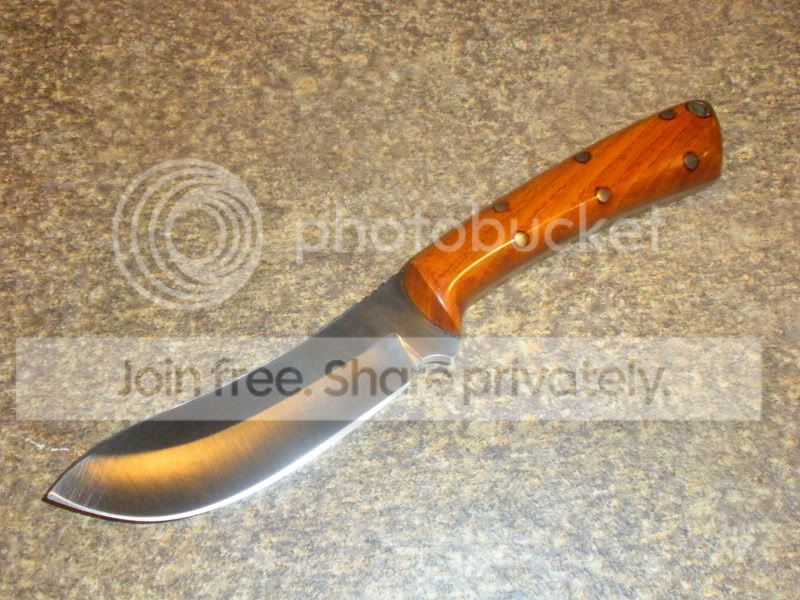

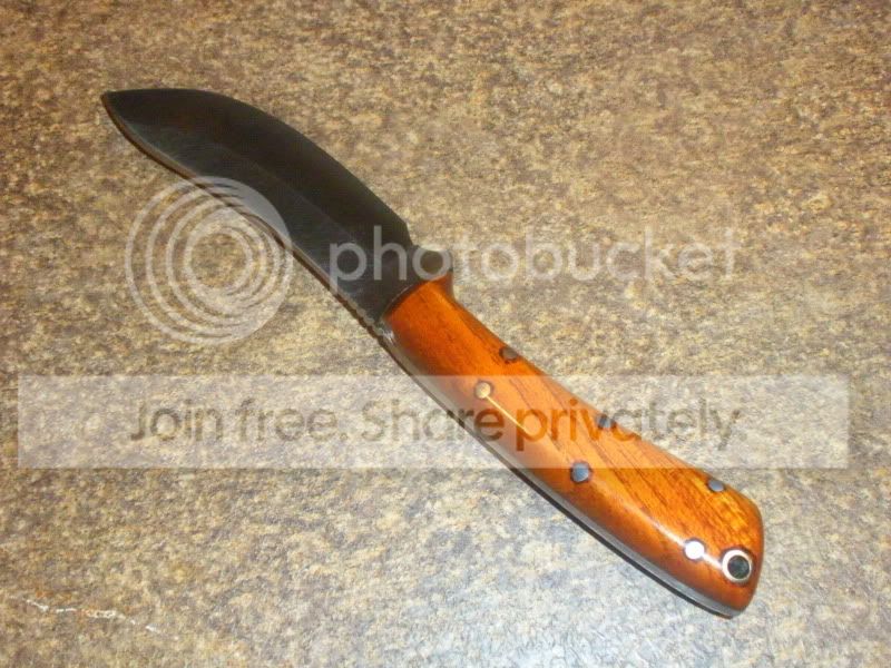

Here are some pics of the mess up and how I turned it into some character :)
Forgot to mention that the scales were lightly stained using a quick swipe of Fiebing's Pro Oil leather dye in light brown. Then, they were finished using a few coats of Tru Oil, buffed between coats with ultra fine steel wool.
The random marks on the blade in 2 of the pics are finger smudges, not scratches.
Guess I'm a bit late on this, but you really didn't have to stain the osage. Give it a week in full sunlight on the dash of your truck and the wood will naturally turn a "rootbeer" brown. It's photo-sensitive wood, the burn rings would disappear for all practical purposes. Heat/burn actually breaks down the surface cellular structure a bit and unless you are very good with a feather flame torch will only make the handle worse. Ma Nature can take care of it just fine.
Also the natural darkening by sunlight allows the "play" or chatoyance of the wood grain remain, staining sometimes muddies this inherent beauty that is osage.
