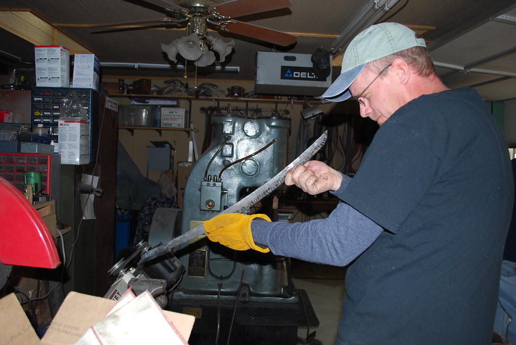

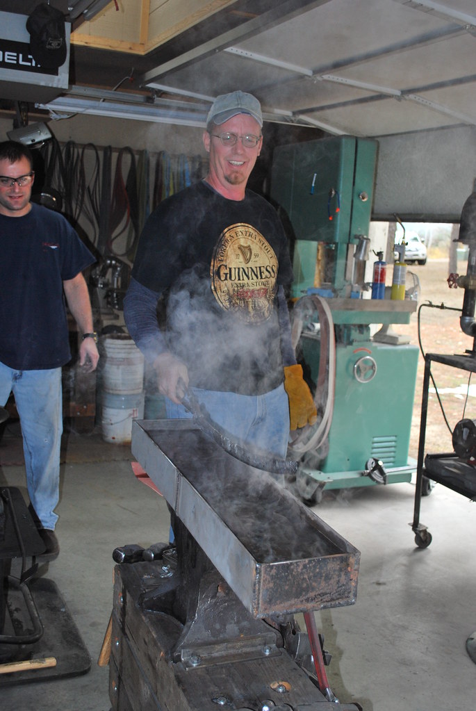

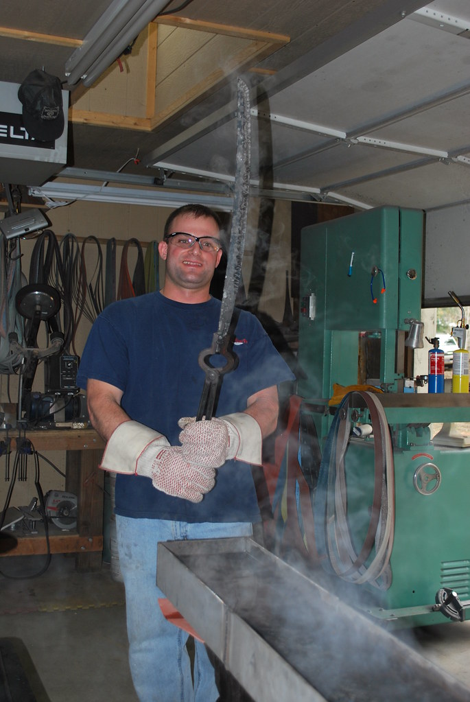

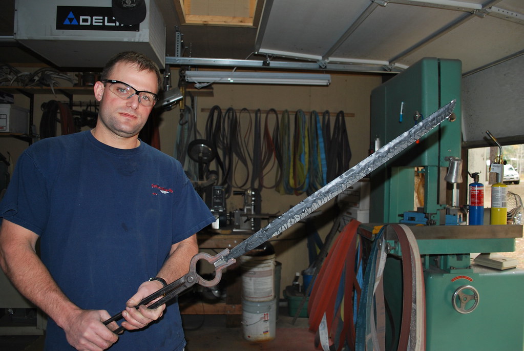

I recently had the opportunity to forge my first wakizashi. Dan Pfanenstiel came up and walked me through the process. I used Don Hanson W-2 and Dan used W-1. I've cracked lots of small W-1 blades in water so I was almost certain this one was headed for the trash. I can't explain the feeling of seeing a straight blade going into a water quench and having it come out curved other than FREAKIN COOL!:eek: I can't help what wonder what the first Japanese smith thought when he saw it for the first time. My blade ended up with a 5/16" sori and a very even hamon, can't wait to polish it out.
Dan, thanks for all your help. I had a blast.

Nick, i was having such a good time I didn't even care that the blade broke. It didn't crack in the quench, which suprised me. it hardened from edge to spine in a couple of places, due to overheating, and broke in two when I tried to straighten it in the vice. The funny part was, after hand forging bevels for thirty minutes or so, I could barely hold the hammer (it's been two years since my last forged blade, I think). Gotta get my mojo back, just takes time.

That's great! Really fun video and pics. I look forward to seeing it finished Mike. Did Dan forge in some sori before the quench? There was a ton of curve on that one.
