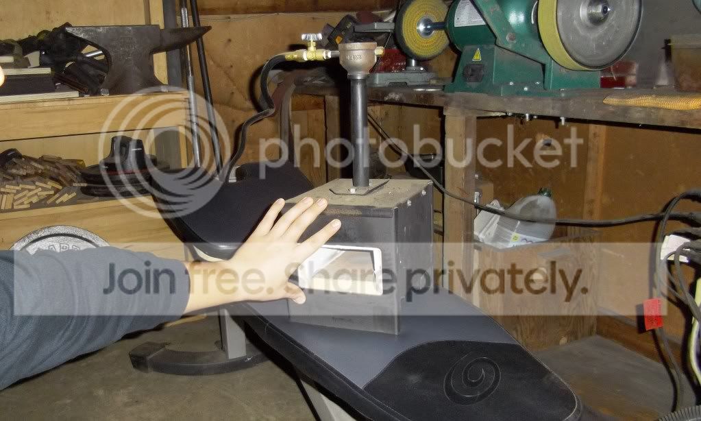

So here's a pic of the small forge I use. Do any of you have a reasonable fix so that I can make it temp control. I can add a piece of tube / pipe. to create more of an oven effect. Does it matter what kind of pipe? Also what would be the best way to read to temp?
Hand is in pic for a size comparison.
Thanks for the help
