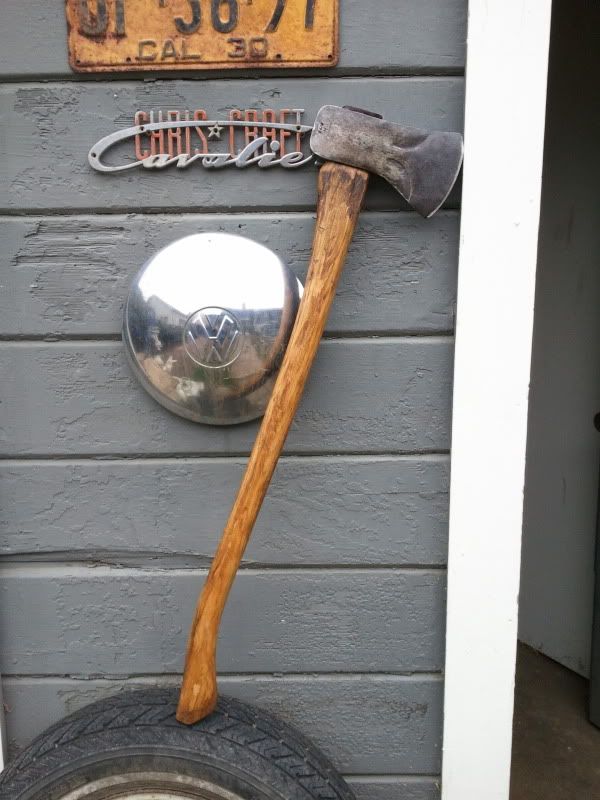

Made some 3:2 mixture and applied it just now. Makes for a very interesting color so far, but we'll see what it looks like once it ages a little. Sort of a golden pinkish shade at the moment that's very distinctive, and I consider it attractive. Definitely looks "bloody" though.
A 2 to 1 mix of two stains plus tossed in some ashes. The ashes don't dissolve well so I have to stir well before applying.
The first application is starting to oxidize now to a rich red-brown with a warm/fiery look to it. I had accidentally gone a little heavy on the oil so the amount of tint imparted is probably on the light side compared to what a more sparing mixture would lend. So far, I'm very pleased with how things are progressing. Providing it all comes to a happy end result then I'll likely be using this stain on a bunch of other handles of mine. Photos tomorrow. I have some on my camera from today but haven't had the time to upload them yet.
Ok--here we go. To start, this ash was blindingly white. Here it is with a base coat of BLO on it.
Here's the blood/oil mixture.
Appearance when freshly applied.
After oxidizing.
