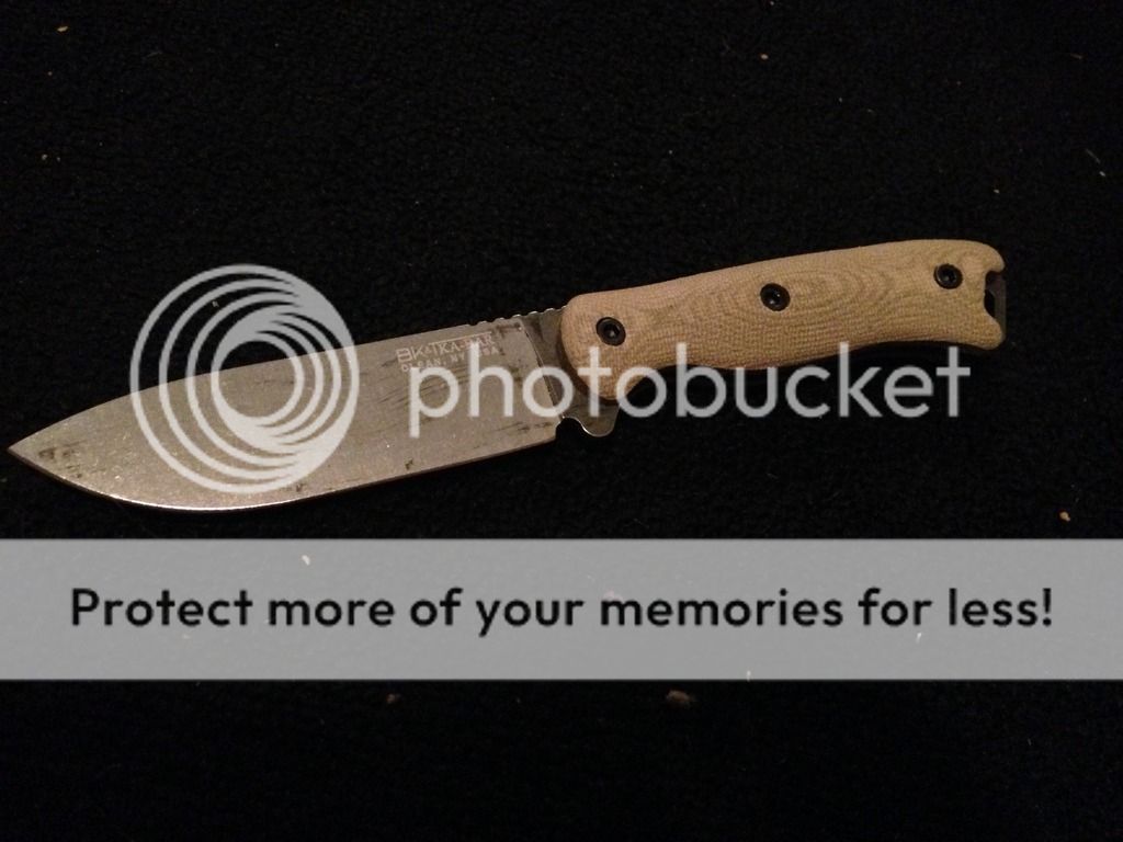

I do have a photo of my BK5 which I did with a mix of red and brown RIT. The green is also nice, and I've been contemplating painting some tiger stripes on a set with undiluted RIT. I'll post that if I ever get around to it.

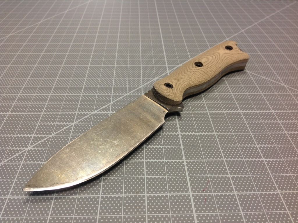

Here's what it looked like before the oil:
After:
The interesting thing is that putting it in the sheath actually changed it a bit as the oil was absorbed a little into the straps.
Also, everyone's right about the more you handle the micarta, the more it will darken as sweat, oil, blood, dirt, etc. gets worked in.

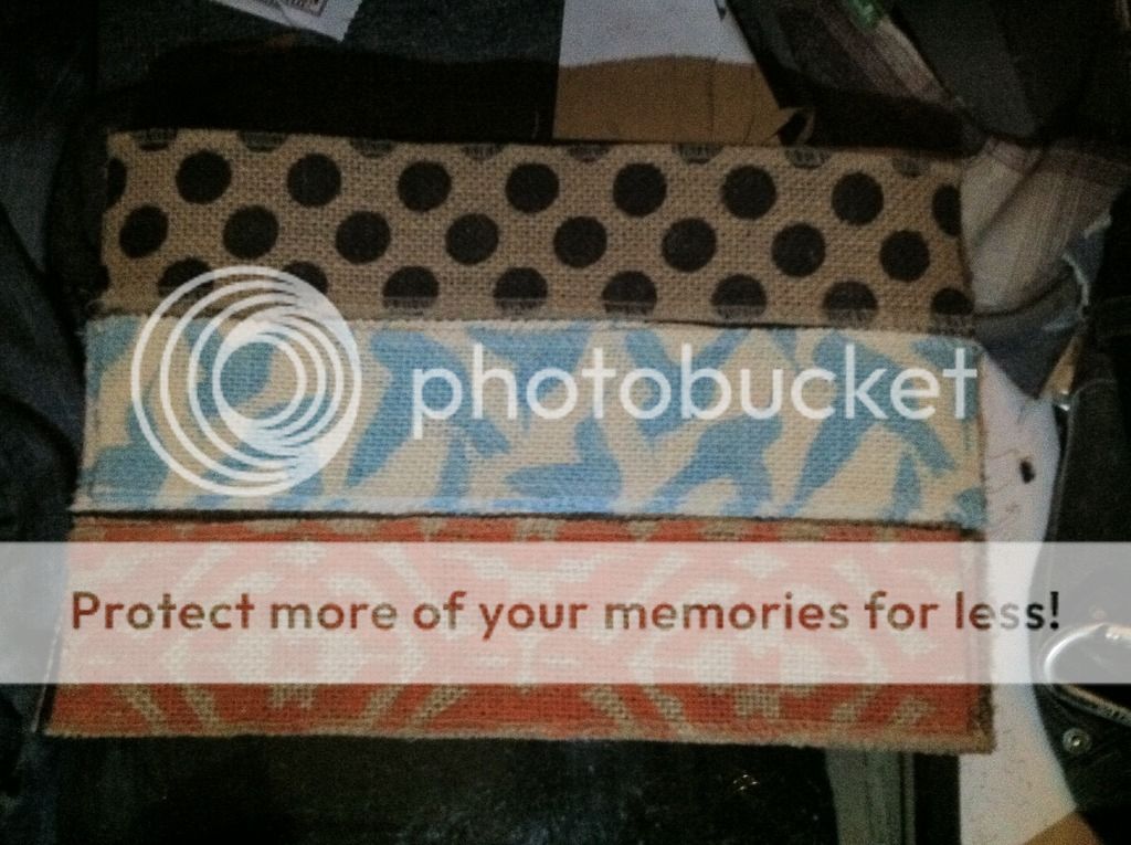

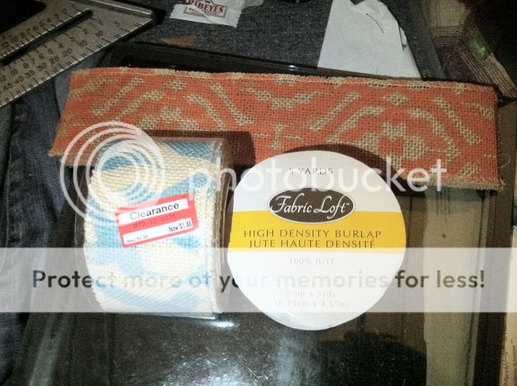

I've gathered up the resin and burlap for home made scales but I'm still floundering on a press design. Not sure if I should make a squared mold or just press it between two boards
$1.48/roll was a steal! 15' each. Looks like I can make 1 set per roll. I'm considering adding denim or linen to make it two toned and it may double my material to 6 sets. I plan on a complete write up on the process.
Looking forward to the write up on that. The bottom set of burlap looks like it will mak a great set of micarta scales.

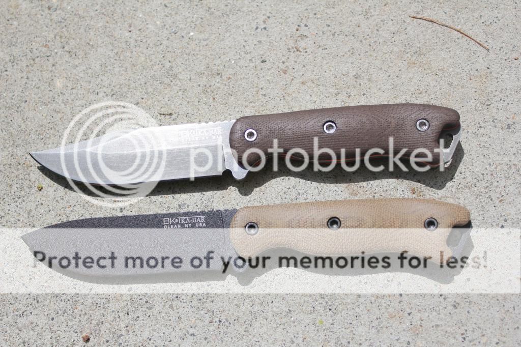

Also, Ka-Bar micarta thru the years has been different colors. A few years ago it was much darker, more of a brown, than it is lately. The last few orders I got were pretty light. Sorta tan-ish with a slight hint of green. So yes they will darken up over time as the oils in your hands are absorbed, the out come will still vary depending on original color.
Here is an example of the some of the different colors they have used. The first one, I believe, is the earliest BK-11 micarta, the second is somewhere in the middle, the last is some of the newer stuff. However, I have received some since that is a little darker as well. So looks like the color is changing once again.
