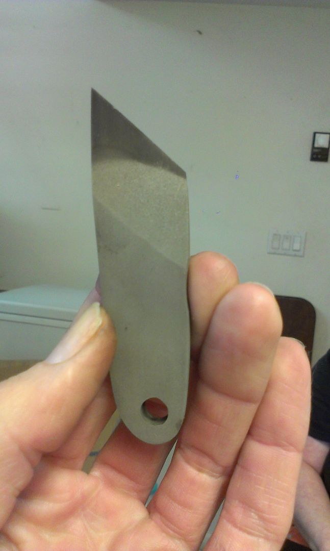

Okay so I made an ugly little dashi last night. HT went well and it's almost ready for final finishing.
My question is...
I coated the edge with Rutland furnace cement before HT. Today while ferric chloride etching I got a darkness at the edge. I've sanded and re-etched a few times and it keeps darkening in the same spot. It's even on both sides.
Is it possible this is a hamon?
Well I sanded it with 400/800 wet/dry and polished the bevel a tad. There's a pretty clear line where it darkened. Not sure if it's a hamon or not (what else could it be?), but it looks cool. I'm just surprised because I really didn't try to get one. I mean I threw some "clay" on there, but really didn't expect anything.
I'll keep playing with it to see what happens. Sorry if this is something that everyone does without problems, I just thought it would be harder to achieve?

Did you put just a skim layer on the edge and a thicker layer towards the spine?
I put a rather thick layer just where you see the line develop. I didn't put any where the dark area is. The tutorial I watched had the guy coating the entire blade, then thickening the clay toward the spine. I thought about doing that, but didn't bother since I wasn't expecting anything anyway.
Edit- oh, and I did allow the clay to cure with some indirect heat for a while. The clay turned light gray, but I very much doubt that it dried fully.

Did you use the 1095 or 1084? Either way you probably got atleast a temper line if not a hamon. Pretty close to the edge on the heal though. Dont have alot of sharpening left there but oh well. On a blade that thick in the body you probably need very little clay to bring out a hamon if any at all. I put a hamon on my W1 dashi I forged out. There are pics in the gallery section (redwood kiridashi) if you wanna look it up. Its just a baby hamon though.
A temper line, that's probably all it is. I was using the terms interchangeably, but I think I meant temper line. :)
I used 1084 quenched in canola oil. I agree, the hardened portion is not very big at the heel. Honestly I made it just to practice a couple of things and it won't get much use. It was clear to me pretty quickly (like right after I cut the steel) that I made the piece too short. I still went with a tall bevel because I figured the trade off of little handle instead of obtuse edge was better for me. If it were overly obtuse there's NO way I'd ever use it for anything at all. ;)
Even so, the grind widens enough where it runs out of hardened steel that I'd have chucked the thing before sharpening into soft steel anyway.

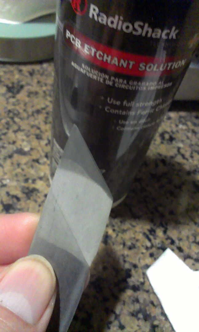

No, but I'm working on it. After my last post I reground it dead flat other than a couple of small areas, but for this demonstration, that doesn't matter.
There's a thread on FC that I was looking at, in it was a link to an older thread that was about how the author brought out his hamons with the acid. I loosely followed his steps. In my case sanding to 600 grit, then a 10 second dip/rubbing with a cotton pad, etc..
First thing I noticed was that the dark area reappeared instantly the second the blade hit the acid/water bath. That was fresh steel so I now have no doubt that it's a product of the clay/ht.
I took a couple of pics while doing this. I'm out of polishing compound, so just rubbed the area with green compound. There are two lines that intersect at the heel. Without diffused light it's hard to tell in the pics, but the steel is a really pretty gun-metal color. I still need to buff it out once I get some compound to see what the final look is, but I'll definitely be trying this again. Even without a temper line, hamon or ashi the steel looks good enough to try again.
The pics suck. I'll try to post better ones after I get more polishing compound.
The instant it hit acid

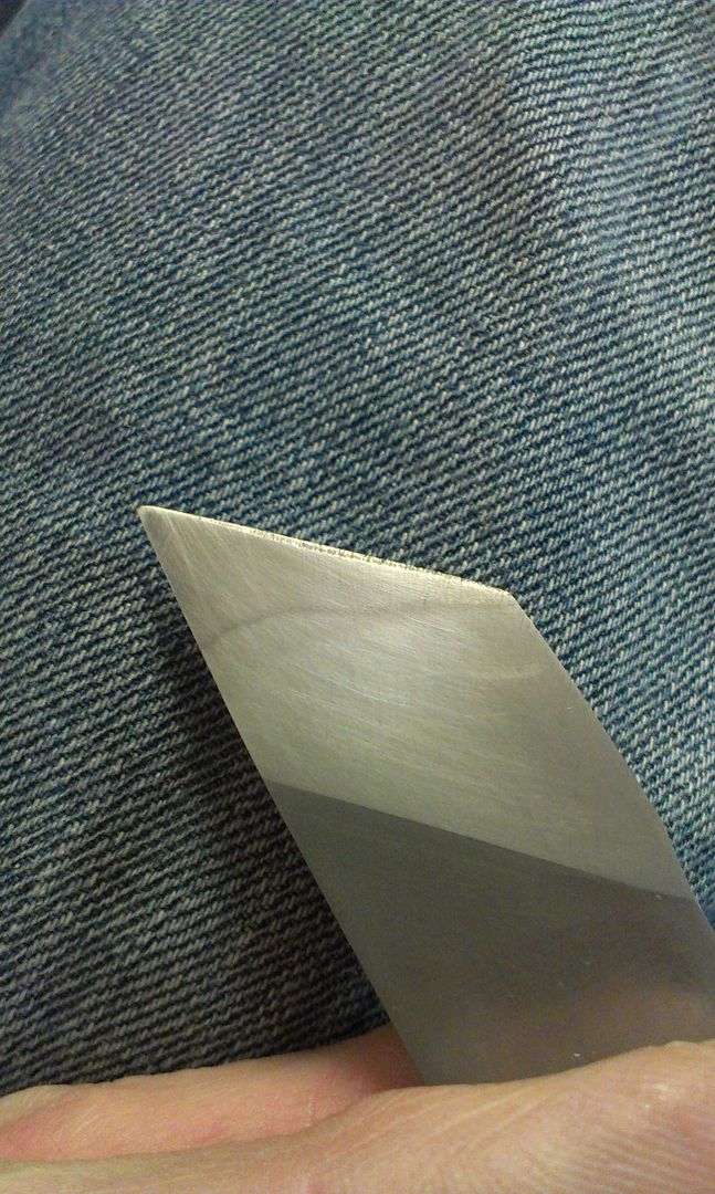

After light buffing
Bah! Now I'm confused. I polished the bevel to a near mirror and the line is gone again.
Unless someone else has a better idea I think I'm gonna forget about FC for now and try rubbing with a super diluted lemon juice.
