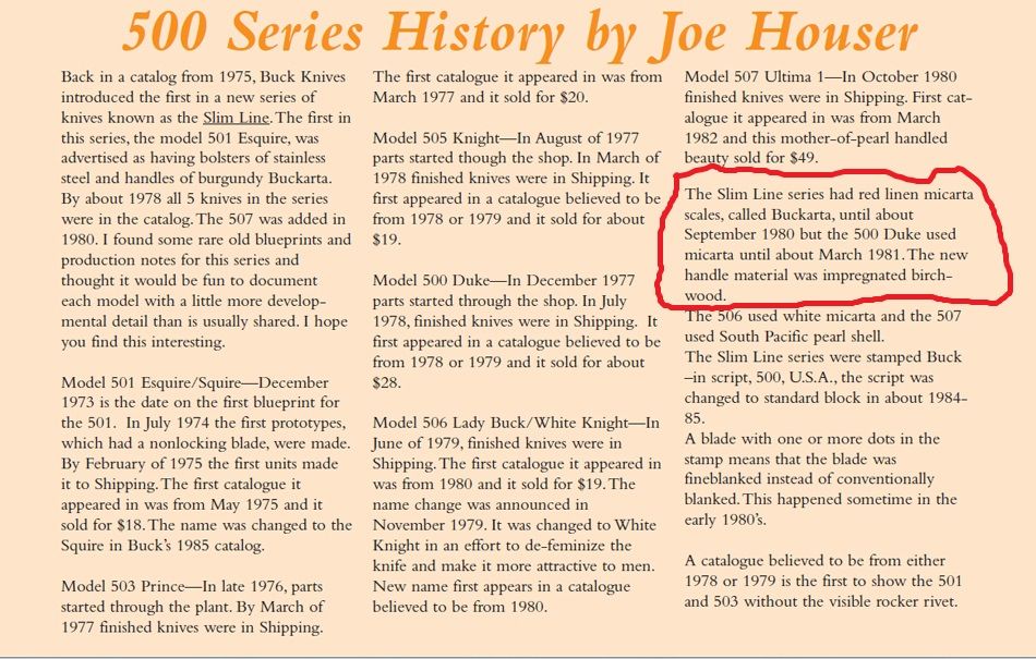

The 501 changed from the script type lettering to block type in '84/'85, but they changed from the maroon micarta to birch in Sept. of 1980 according to Joe Houser's article on the 500 series.
The first blueprints for the 501 are dated Dec. 1973 but the first one's didn't ship out until May of '75 and had an exposed rocker rivet. The exposed rocker rivet went away about '78/'79.
If your 501 is micarta, with the script lettering and has only two rivets showing on the handle, it would be from as early as 1978 and up until late 1980.
Yes, two rivets and that date era sounds more like what I remembered. It didn't seem to me like I had this as early as 1973 and must have carried something else in my college days. As I think about it, for a few years I carried the 110 but it was larger and heavier than I needed. The 501 was like a miniature 110 and that's what prompted me to buy it. Late '79-early 1980 sounds about right.
That's terrific info, plumberdv, thank you very much!!
Sounds good. I wonder about that Sept. 1980 date of the switch to birch but I'm away from my notes so it will stand for now. DM
Boy, that's a gem of an article! Thanks for posting it.
