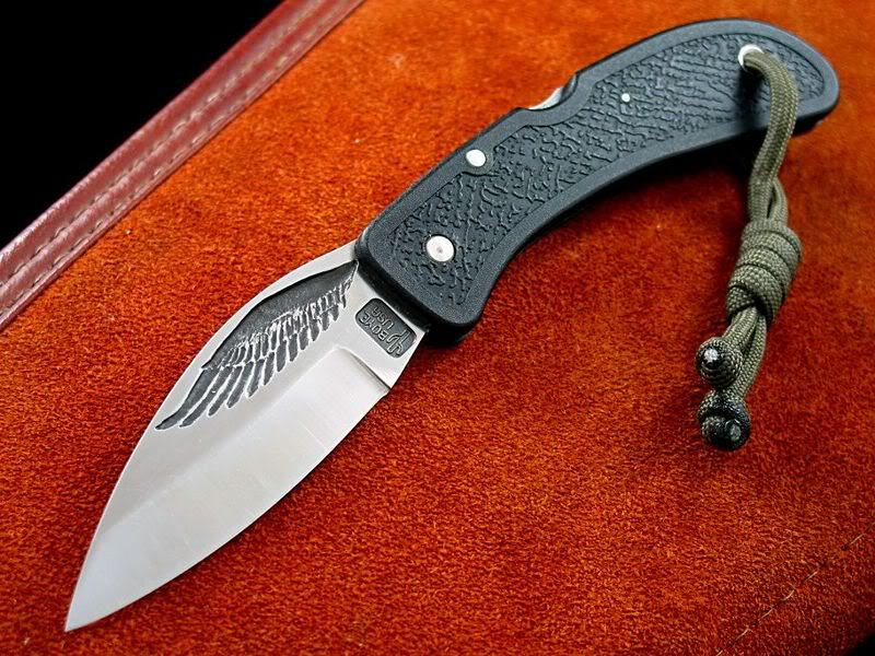

Thanks for the excellent review Gary. Just last week I kept going back to the Boye website with the intent to pull the trigger on that same knife. I have an older model Boye cast dendritic 440C with the eagle wing on the blade. It is an amazing knife, and is one of, if not the sharpest knives I've had.
Your review may have tipped my scales towards the cobalt again. :)
Hope you don't mind me sharing a shot of my Boye Eagle Wing Prophet.

And Fewpop, nice shot! I've owned several with various castings
Sunrise, whale, primitive archer I think.
