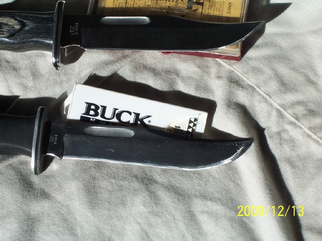

Gordon, These two 119's were mfg. 19yrs. apart. Notice the thicker blade on the lower one near the edge which is the old style grind . The top knife has the edge 2K grind which is much thinner . I'll be using these two 119's on the Mule deer processing today . I rebeveled the 3 line giving it much more relief . One has ATS-34 steel the other 440C . Which will cut better ? DM

I'll bet the ats-34 shines in butchering,that thicker edge might work better on a variety of things though,but for butchering,the thinner grind should shine there.Nice pictures thanks for posting them!

Both 119's were capable of trimming fat, tissue paper thin .The handles felt good, no fatigue or hot spots . I'd be hard pressed to determine which knife had which steel w/o prior knowledge . A higher grade steel serves more of a function of cutting abrasive material longer, toughness and other items like stainless . But in cutting quickly all things being even close, thinner cuts quicker always .
So, it was when I would cut deeper in the meat that I noticed the benefits of the edge 2K grind over the older 119 w/ thicker blade profile . I had only sharpened it stopping at a 600 grit India stone which could pop hair like a lazer .
