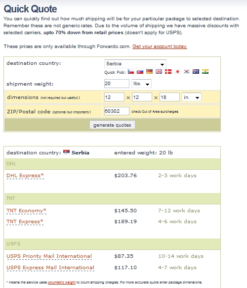

Just for fun I looked into what the shipping costs for a treadmill motor the size of mine would be to Serbia. It was interesting.
Not as bad as I expected actually. So if the motor was cheap enough this might be a doable option. Find the right size motor on eBay and send it over. Probably take a couple of (anxious) weeks I'm afraid, but possible.
That could be an option.. I will try to salvage this one first, 'cause I lost my job recently and must try to be an even bigger cheapskate than before :D
