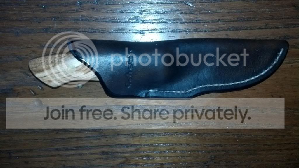

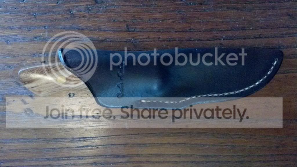

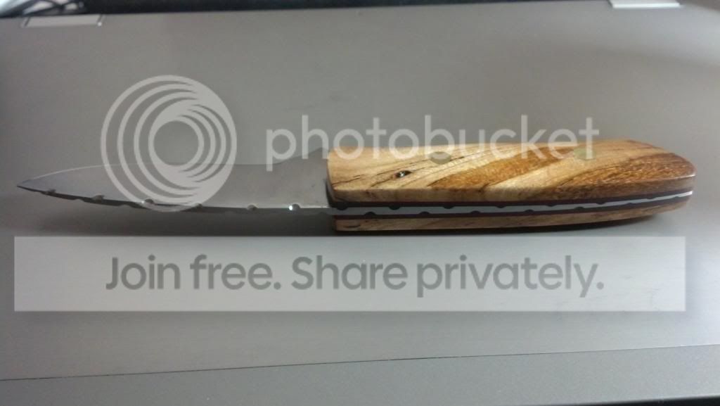

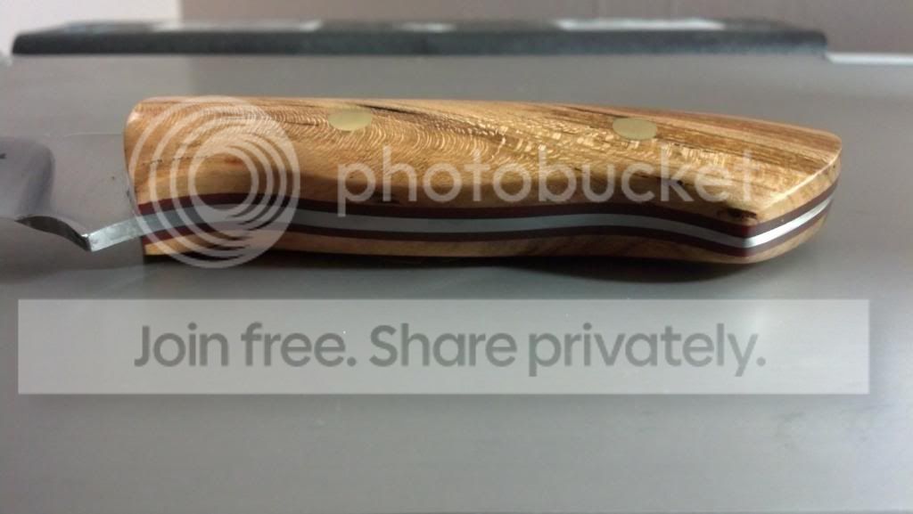

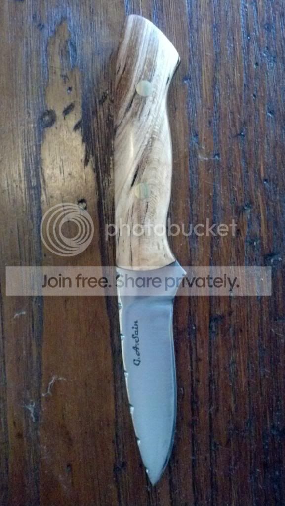

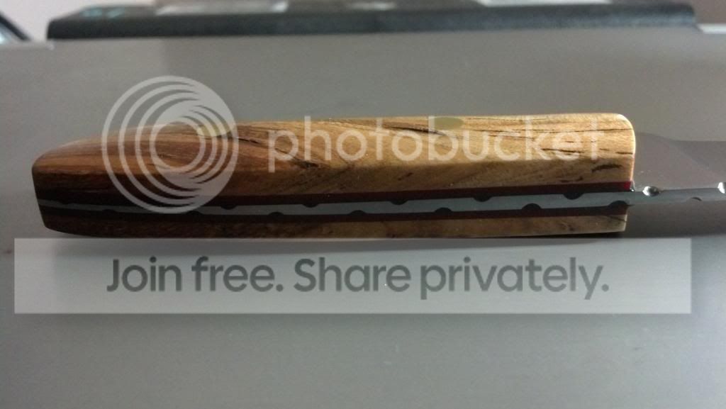

I just made this knife for my Dad's friend who has been looking after his place after my dad lost his legs and could not live in the mountains anymore.
This guy not only has mowed the lawn, checked on the house, kept an eye on things, but also lends me his truck when we go up to hunt, since my dad's handicapped minivan doesn't go far off road, but it will take a deer in the back :)
Anyway, I wanted to make a knife for him as thanks and now I don't want to let it go, I've become attached
Of course I will still give this to him on my next trip, I can put it down anytime I want. I am in complete control.
Attempting to link to come cell phone pics:

Very nice looking hunter. Is that hickory? Really pretty stuff.

Thanks for the kind words.
Funny, usually we read about people using mystery steel. Well, to be honest, I know the steel (1084) but the wood is a guess at cherry, or a mystery.
I found it where I was cutting up some cherry but not until a couple of weeks after. I think this was in the root section where the grains run in all directions. If it isn't cherry, then I have no idea in the world.
I cut it into slabs, after it started really checking and splitting up during drying. I figured that cutting the twisty grains up might relieve some stress. It seemed to work, it didn't crack any worse.
Then I put it on my heating ducts for 1+ years and then "stabilized" it.
I like the character and wish I had been able to save more than one knife's worth of handles out of it.
It is finished with 6 coats of tru oil, some of the unique grain splits and inclusions were left for character, and I am waiting another day or two before giving it a coat of microcrystalin walnut oil was (Doctor's Workshop?)
