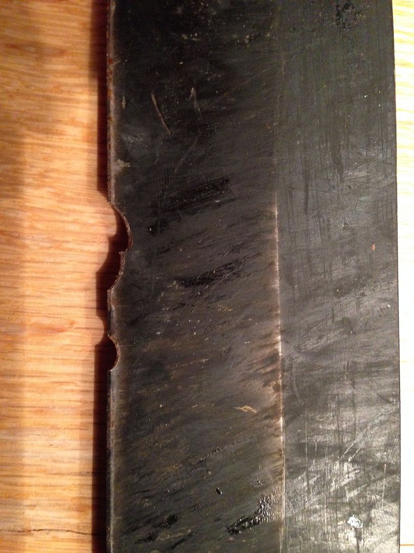

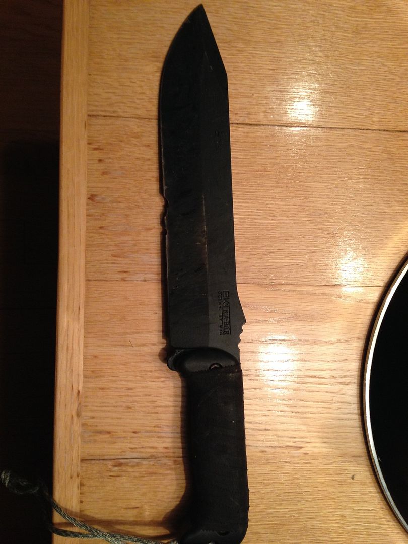

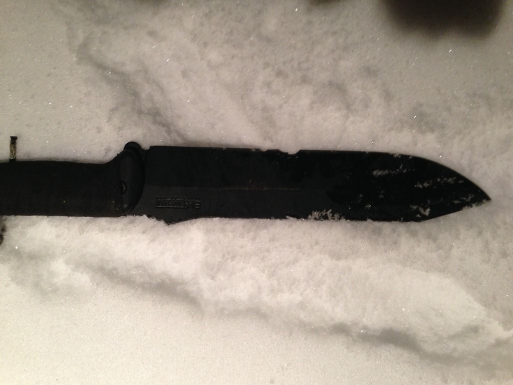

I was very surprised when my BK-9 failed me on a bushcraft expedition. I went on a two night winter camp with my friend and worked on building a survival shelter.
While I was chopping branches of a pine tree (dead white pine) the blade chipped drastically. I never had a blade chip so badly in my life.
It wasn't even that cold (zero degrees celcius) and I have done more intense work in colder temperatures many times with other knives.
Could it be a defective heat treat ? Will Kabar replace it ?
Here are the pics of the knife

you hit a knot - especially on a dead pine/hemlock tree, the resin gets as hard as glass as far as knives are concerned - between that and the twisty grain, they are kryptonite for choppers.
email the pics to Kabar to let them know it's coming, then mail it in with a copy of your post so they can decide if it was a flaw in the steel (hidden inclusions are no fun and nobody's fault) or what happened and they will let you know if they will replace it once their QC folks have had a look-see.

My friend had another knife and had no problem going thru the same wood.
Makes me think it might be the heat treat
He used an Ontario SP8
The thing chopped thru ice and wood with no problem
No edge rolling and no chipping
the SP8 has a much thicker primary grind and like I said - if you hit a knot wrong, it can shear steel.
This is just adding to my distrust to kabar's HT.
Kabar will replace it since you haven't stripped the coating.

doesn't the FAQ by now say this? every winter someone chops a dead xmas trees, and this happens. ;)
don't chop those things. even with an axe. i broke an axe head that way once. throws sparks. silicated ligin is bad enough, but then you freeze it? oiy.
classic chonchoidal stress fracture in a hard material.
course, there's 10000000s of people doing this, and we only get a few chip outs.
so. not a lot to distrust there. it's like hitting a pot hole. most of the time it's okay. sometimes it's not.
that's why a warranty.

I wouldn't worry about the heat treat on Ka-Bars either.
Shit just happens......though it does seem to happen in winter more....

Thats not death but merely scars of a tough day on the job. It will come out with a bit of a modification. Grind it back and it will be fine.
