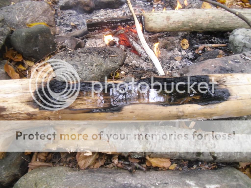

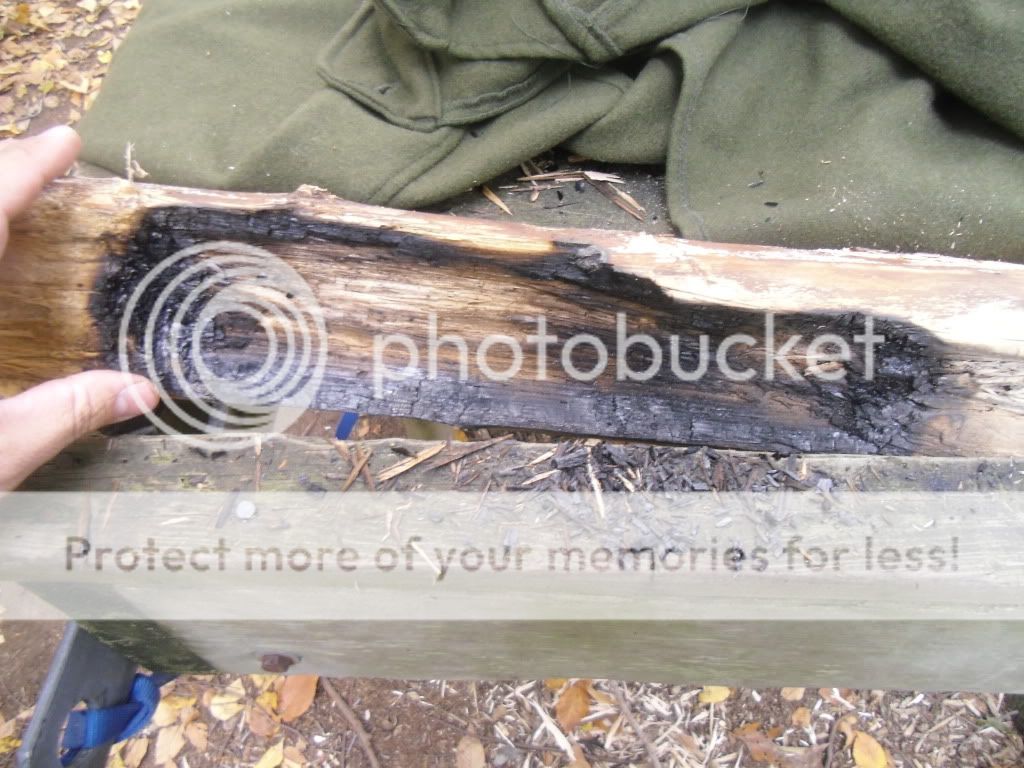

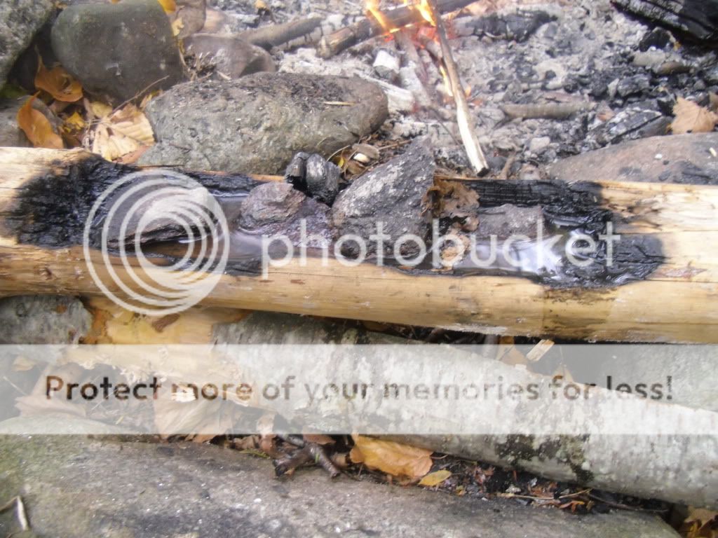

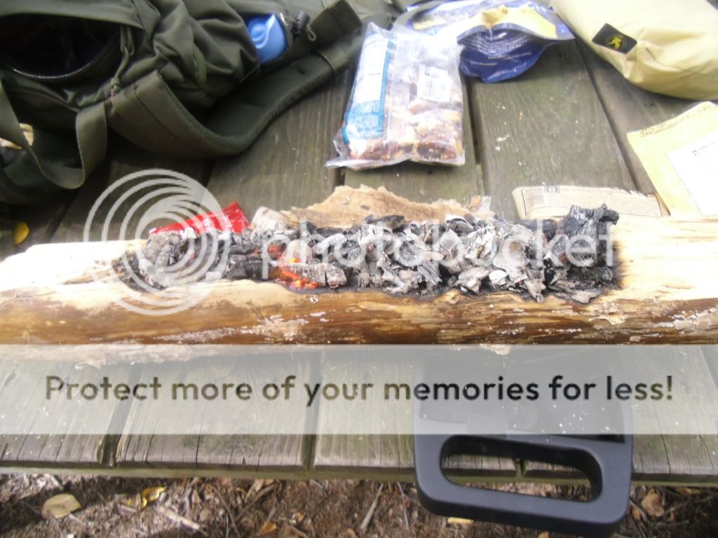

Here are some pics from a similar experiment I did a while ago,, the water boiled, but it wasn't enough water, and the der[esseion was to small to suply enough rocks to keep the water at a boil
Using coals to hollow out a log
an depression
Holding some water
Hot rocks doing the boiling
Hopefully this month I;ll be able to refine it some.

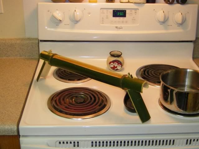

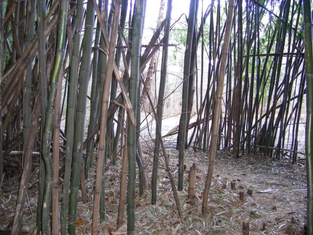

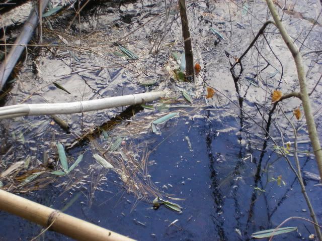

I went out yesterday around dusk, after an excellent tree rat pistol hunt:D, and collected a section of bamboo that was on my way back from the mountains. My first contained holds 14.8 ounces (close enough) and still has enough room for the boil to not spill over. I tested it over the stove top and it boiled nicely but it doesn't count until I do it over hot coals in sub freezing temps. I'll knock that out this weekend.
Bamboo grove that I collected from
Both the lake and my water bottle was frozen:mad:
Finished container being tested over stove
